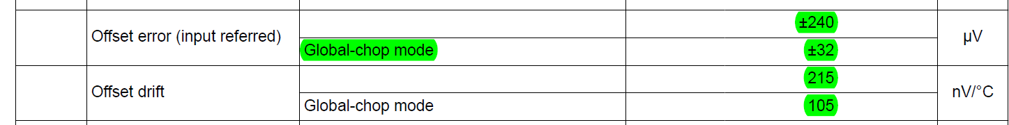

If MUXn[1:0] bits in the CHn_CFG to short the input of a certain channel, every 10ms, can the offset error can completely calbrated ?

thanks, but will it be better than global-chop mode? will the offset error reduced to less than 1uV?
the signal I am measuring is less than 1Hz, so wonder whether "zero-drift" can be built by this on-board self-calibration……

Global-chop mode can reduce or minimize the offset error and noise than normal operation mode. I do not think you can reduce it less than 1uV, and also you need to confider noise.
