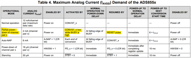

Do I need to change the hardware circuit diagram, software register configuration, and software timing to replace ADI's AD7658 with ADS8558 P2P?
Hi Allen,
Thanks for your post. The devices are P2P. The main difference is: The power-up sequence from partial power-down to normal operation is different between AD7656 and ADS8556.  For the ADS8556 another reset pulse has to be applied to wake up the device again, for the AD7658 a CONVST pulse is required.
Samiha
New question:
In our existing design, MCU the give ADC7658 reset signal to the pin 28 only one time during the drive initialisation.
But from the ads8558 datasheet, we can see the reset signal works during the signal transferring.
Is that what you mean "wake up the device again"?
  • Hello Allen,
    What Samiha was referring to was the devices going from a partial power-down mode back to normal operation. Both devices have a functionality where any channel can be placed in partial power-down mode by setting the CONVSTx signal low before the falling edge of BUSY. To exit the partial power down mode, the AD7658 requires a CONVST pulse before it goes back into normal operation, while the ADS8556 requires a RESET pulse instead.
    Doing a reset during initialization is a good practice, and in this aspect the initialization sequence does not need to change between both devices.
