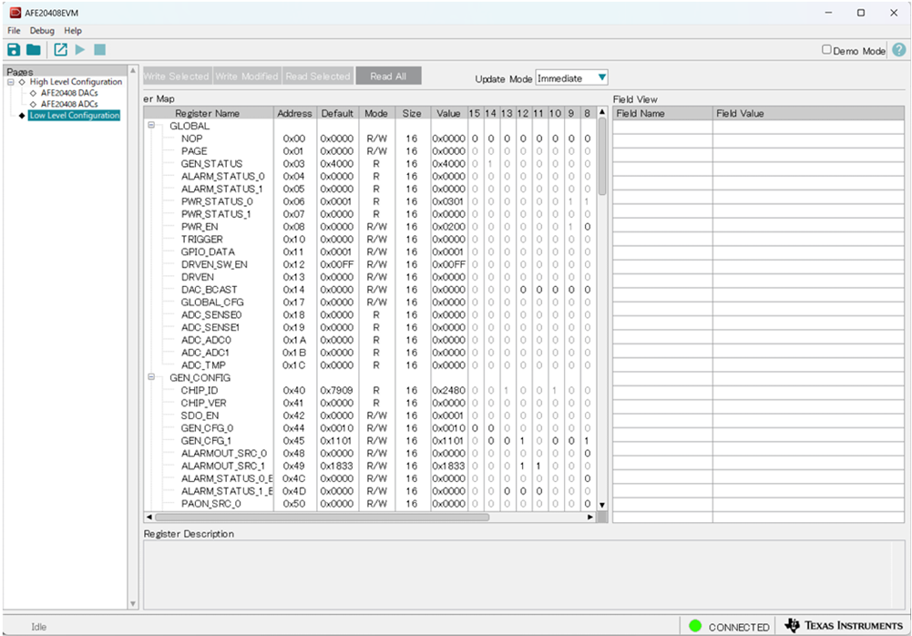

My customer informed that they cannot see the DAC output. They are using AFE20408EVM. Please help to solve this problem.
The customer's register setting information is as below.
I translated the following E2E information into Japanese and sent it to the customer to configure according to this content, but they cannot confirm the DAC output.

  • Hi T.Imai,

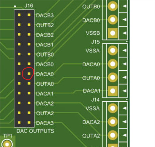

    Based on the photo you sent, it looks like they did not write any data to the DAC. They should write the ideal DAC value into the "DAC_BUFFER" box.
    Once they set this register, measure the voltage on the circled pin.
    The EVM GUI is meant to be used in tandem with the data sheet. The "Low Level Page" shows the entire register map of the device. You can double click the "value" box of a specific register to write your hex data into it. The below picture shows how that would look like. You can also read the current value of a register by selecting the register and clicking the "Read Selected" button at the top.

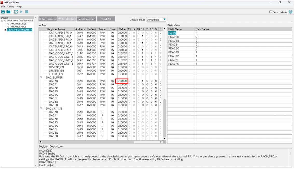

  • Hi Eric-san,
    I received the following reply from the customer.
    ・The value of DACAx_BUFFER has changed in the past, but the output pin voltage has not changed.
    ・I confirmed that the register value is also the set value.
    ・Below is the GUI screen captured. Please check if there are any omissions or mistakes in the settings.  DACA0_BUFFER is 0x1000.
    ・I pressed the Read Selected button and verified that DACA0 is 0x1000 asbelow. However, the voltage on the DACA0 output pin did not change.

    I'm still suspecting that they are not measuring the correct test points. Please have them read the following registers:
    -GEN_STATUS
    -PWR_STATUS_0
    -PWR_STATUS_1
    -DACA0 in the DAC_ACTIVE section
    These will help me determine if there are any errors preventing DAC output.
    If not, please ensure the customer is probing one of these locations. If the customer is probing the pin to the right of DACA0 circle, they will measure 0V. By default, all DACs start up in the negative voltage range, so measuring 0V means they are not actually measuring the DAC.

    I got information fro the customer that they could see the DACAx output voltage by changing the DACAx_BUFFER registor.
    That was happened after they supplied -5V to both VSSA and VSSB.
