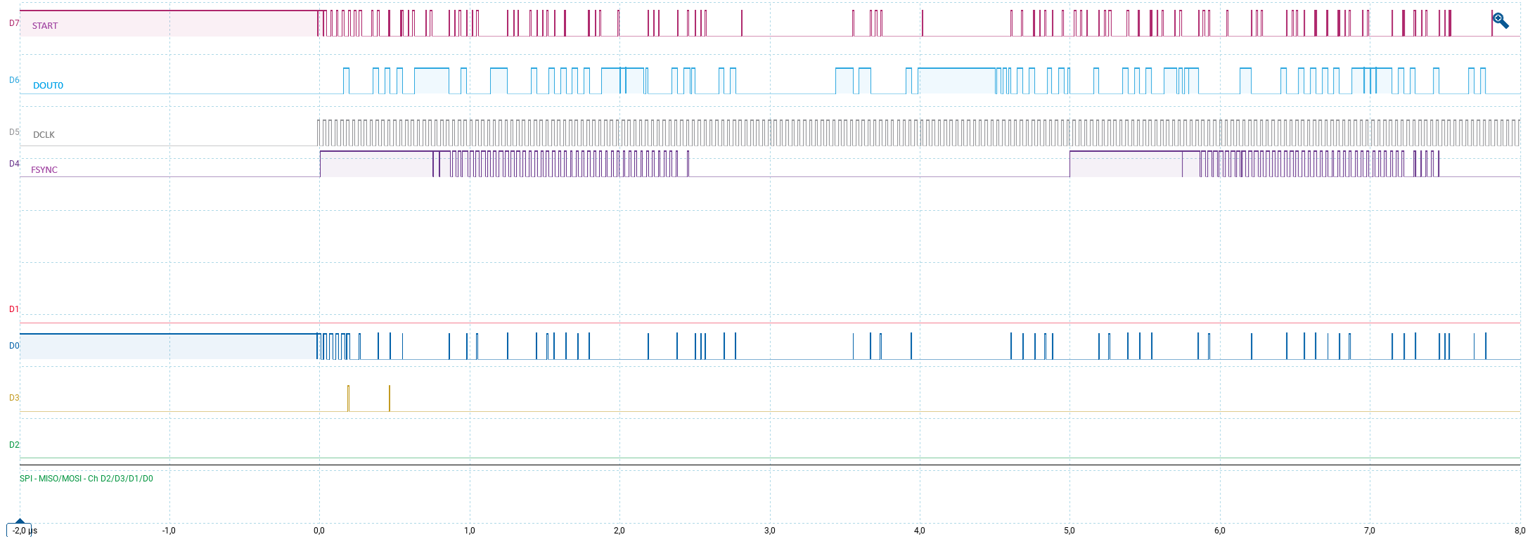

Here are the logic analyzer results we see, when we capture 2 samples (D0-D3 are SPI; can be ignored). Single trigger on FSYNC after pressing capture button in GUI.
According to my understanding there are continuous restart conditions and also the fact that FSYNC and DCLK look nearly the same at times, doesn't make sense to me.
Even if we would not use TDM there should be 32 DCLK cycles within 1 FSYNC cycle, or? With 2 data lanes (TDM=4), there should even be 128 DCLK cycles.

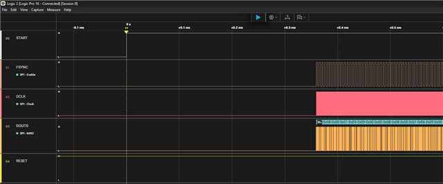

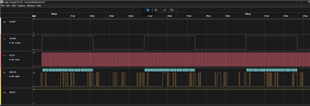

  • Hello Peter,
    Welcome to the TI E2E community.
    The ADC should work well for the settings that you are using.  Using OSR=64 and the internal clock, the data rate, and FSYNC frequency, should be 200kHz.  Also, there will be 128 DCLK's per FSYNC period, which will allow 4x 32b readings (8b status plus 24b conversion result).
    The SPI address error should not interrupt readings.  Once you start data collection, it is recommended not to read/write over the SPI port to reduce reading noise caused by the SPI SCLK.  Since you are triggering the the SPI Address Error, I assume you are trying to read or write to the internal registers during data collection?
    This is likely some sort of noise on the SPI port causing the SPI port to see an incorrect address.  I suggest using an oscilloscope and capture a full SPI frame, including the /CS, SDI, SDO, and SCLK signals.  Also confirm you are using 1.8V CMOS logic levels; the ADS127L18 does not support any other voltages on the digital pins.
    The logic capture shown above appears to have a large amount of noise during the capture.  The FSYNC should be a 200kHz, 50% duty cycle, for the settings you are using.  DCLK should be equal to the internal oscillator frequency of 25.6MHz.  I would check the logic level setting for your logic analyzer; if you have the logic analyzer set for 3.3V logic, it will result in a large amount of noise similar to what is shown.  Below are two frames of captured data from the EVM, where the START pin is used to control the device.
    Also note there is a large delay from the rising edge of START before conversions begin due to the settling time of the digital filter.
