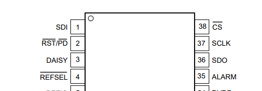

Part Number: ADS8688W
On page 3 of the datasheet, pin 3 is listed as DAISY and pin 4 as REFSEL, but in the Layout Example on page 68, pin 3 is listed as REFSEL and pin 4 as DAISY.
Which one is correct?

the pin map on Figure5-1 is correct, Pin 3 is Daisy and Pin 4 is REFSEL.
Apologies for the confusion, we will update the layout example diagram.
Thank you for brining this to our attention!
