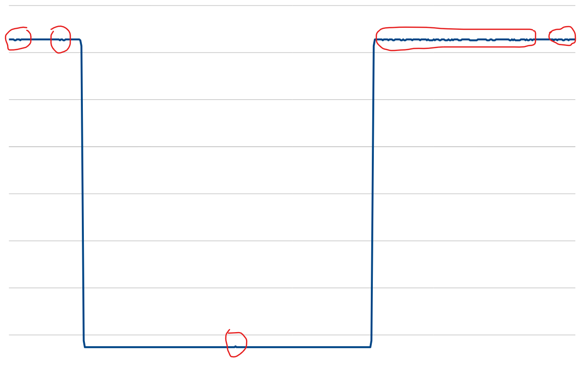

I'm seeing a small issue in the data on our custom PCB and wanted to get your review.
  1. Raw ADC data occasionally changes by 1 ADC code for a single sample e.g.: 15, 15, 15, 14, 15
  2. This creates a visible spike or glitch in the calculated voltage and plotted signal.
  3. The is present in both internal test square wave signal and external input signal with ECG simulator.

Attaching schematics and plots. Also wanted to review decoupling capacitor placements etc.

  • Hi Lancer,
    It seems reasonable to expect ±1 ADC code simply due to the noise of the ADS1198. For a 16-bit ADC with VREF = 2.4v and Gain = 12, your LSB size is only 6.1µV.
    Decoupling caps should be placed near the device, ideally with power traces running through the caps and then to the pins. It looks like your schematic has the recommended capacitor value pairs.
