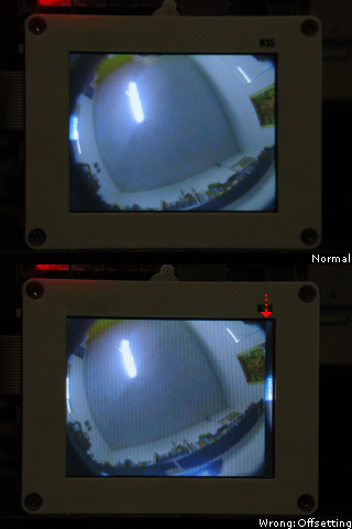

I'm currently working in a project with arm9 and the TVP5150AM1, and i having a very strange issue, when i connect and disconnect the video signal cable from TVP5150 CVBS input, occasionally the video offsets horizontally, i observed that some noise on input can cause the same issue.
I'm using NTSC video signal:
Registers:
  • 0x03 - > 0x2F
  • 0x04 -> 0xF8
  • 0x0D -> 0x00
  • 0x0F -> 0x0A
Any Thoughts on helping me with this issue?
