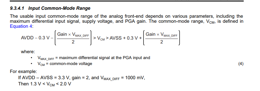

    The Vcm range depends on the power supplies, Gain and maximum differential signal (VMAX_Diff) that is is defined as the maximum magnitude of the differential input signal that appears at the PGA input. Below are two examples for VMAX_Diff =500mV and 100mV according to the equation (4) in the datasheet.

    The description about the common-mode voltage in ADS131E08 datasheet is not quite clear, what it shows is that the internal PGA has limitations and your input must be within a certain range because the PGA is limited. The PGA is formed like the front end of an instrumentation amplifier. Because of this PGA input is limited by the amplifier range of operation, the limitation can come from the input or output range of the amplifiers. Because the input and output of this PGA must have the same common-mode voltage, the input common-mode is more limited with higher gain. The ADS130E08 is an older datasheet. There is a similar but better explanation in some of our newer datasheets. You can look at the ADS124S08 datasheet in the Low-Noise Programmable Gain Amplifier section and PGA Input-Voltage Requirements section for the details.

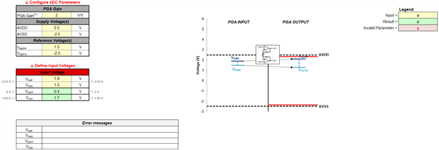

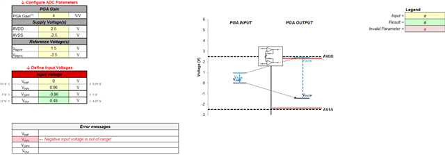

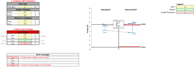

    For the conditions in the second test (Gain=4, Vcm=0.48V) you showed above, the output of the PGA is close to hit the allowable rail, you may not see a bad output if your input is a differential DC signal, however you will see a bad result if you are checking AC performance with an AC signal or you are checking linearity performance.
    For the conditions in the first test (Gain=2, Vcm=1.7V) you mentioned above, the more important thing is to know the voltage applied on the AINP and the AINN pin of the ADC, the result could be different with different voltage on the AINP and the AINN but the same Vcm.
    You may use the following tool as an approach to check, below are three examples with different conditions.

    Example 1:
    Example 2:
    Example 3:
