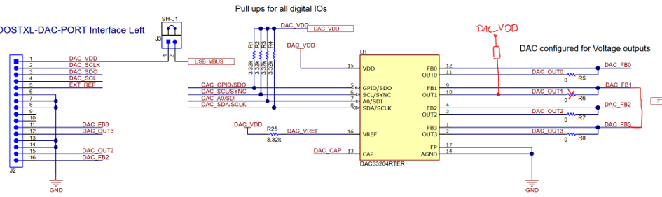

    I did some more tests with DAC in hysteresis mode with latch. The following is my setup:
    DAC63204EVM-Board
    I only removed R6, so DAC1 is used as comparator and DAC3 is used to supply DAC1_FB1. I added a Pull-Up Resistor at DAC_OUT1, because I want to use this output in Open-Drain Mode.
    Configruration:
    DAC1:
    • Marging-High: d1638 (2V Hysteresis at 5V VDD)
    • Marging-Low: 0
    • VOUT_CMP_CONFIG:
      • VOUT_GAIN_1: 1
      • CMP_1_OD_EN: 1
      • CMP_1_OUT_EN: 1
      • CMP_1_HIZ_IN_DIS: 1
      • CMP_1_INV_EN: 0
      • CMP_1_EN: 1
    • CMP_MODE_CONFIG: 0b01 (Hysteresis Mode)
    DAC3 as DAC-Output to supply DAC1 Feedback and triggering hysteresis witch latch.
    COMMON_CONFIG Register:
    Now I am increasing the output voltage of DAC3 (red) and DAC1 comparator output (yellow) triggers at 2V.
    When triggering RESET_CMP_FLAG_1 in COMMON_DAC_TRIGGER, nothing happens, because the input of DAC_FB1 is still over the threshold. I can read out CMP_STATUS, the flag CMP_FLAG_1 says 0. So far okay.
    When I set the output of DAC3 lower than the threshold (to 1.6V), the Output of DAC1 is still LOW, so latch is working here (as long I don’t set the DAC3 Output to 0V, then the DAC_OUT1 is going HIGH again as said in my first post). I can read out CMP_STATUS, the flag CMP_FLAG_1 still says 0.
    When triggering RESET_CMP_FLAG_1 in COMMON_DAC_TRIGGER, output of DAC1 is going HIGH again and in CMP_STATUS, the flag CMP_FLAG_1 says 1.
    But now if I trigger RESET_CMP_FLAG_1 again the output is changing again. The Input of DAC_FB1 is still below the threshold (at 1.6V). I can do this several times and output is always changing. I can do this, as long as the input voltage at DAC_FB1 is larger than 0V and smaller than the threshold set in marging-high.
    So I can toggle the output of DAC1 just by triggering the RESET_CMP_FLAG_1. Is this feature wanted in that way or is it a bug?
    Thanks for any help.
    Dani

  • Hi Dani,
    Finally got a chance to check this and I can see the same thing on my end. Toggling the RESET_CMP_FLAG_1 bit causes the comparator to alternate between a triggered and non-triggered output.
    When it's "triggered" and latched by this reset bit, the latch can still be released by lowering the input voltage to 0V. However, I can't imagine that this is the intended RESET behavior.
    For now, I don't have a work around besides only sending the reset once when the comparator is latched low. I'll have to report this back so we can look at it deeper.
