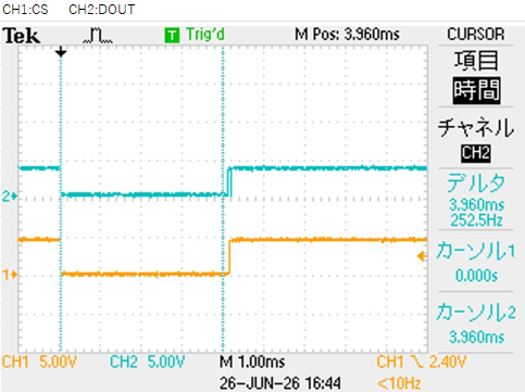

Background: We are using ADC124S021CIMMX to measure a thermocouple-related signal on IN4. The analog input voltage appears stable, but the ADC output code intermittently changes abnormally. In our current timing, /CS is driven low and the SCLK burst starts approximately 4 ms later. The burst contains 16 SCLK cycles.

    1. There should not be a limit on the time between the fall of ~CS and when SCLK becomes active. The input signal remains in acquisition for the first 3 SCLK cycles, which does limit the minimum SCLK frequency, as voltage can leak from the sampling capacitor between sampling and conversion phases if too much time elapses and yield an error.
    2. We have not observed this behavior. However, it is possible glitches on SCLK can cause desynchronization between the device and controller.
    3. If there is an extended amount of time between samples, it is a good idea to bring ~CS high between samples periodically to ensure synchronization.
    Are you able to give more information of the timing, such as the time between samples, SCLK frequency, and whether there are any other factors that seem to cause the issue to occur more or less frequently? Can you also share a schematic of the application?
    If more time is allowed between samples, or less time between the fall of ~CS and when SCLK is active, is there any difference in how frequently an issue occurs?
