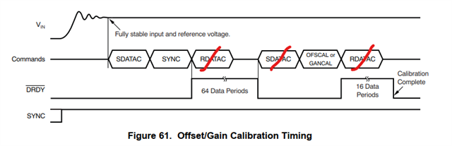

  • Hello Keith,
    Would the following sequence work if using calibration commands (commands crossed red are not executed)? Would nDRDY still behave like shown in the figure?
  • Hello Xavier,
    If you do not send the RDATAC command after SYNC and after OFSCAL or GANCAL, then the DRDY signal no longer toggles and simply stays at a high level.  I recommend using the above sequence in Figure 61 if you are using the CAL commands.
