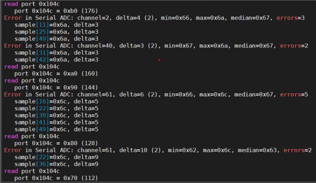

After deep dive investigation I found strange phenomena on the ADS5296A.
We test dc value in few values on all channel with 100 samples and check Repetitiveness.
We except delta for 0-2 bit (one bit = 2mv).
We have card with few channels which fail the test.
The failure in the test depend on the input dc values.
There are values that all channels pass the test.
The failed channel has two results:
  1. good result which change with small DC addition
  2. bad result which didn't change with small DC addition. (stay fix)
in same point of changing the dc input values, the bad result disappear and could start again with different dc value.
bad result could be different between channels.
I never see phenomena like this.
Pls. advise
