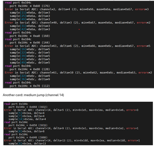

After deep dive investigation I found strange phenomena on the ADS5296A.
We test dc value in few values on all channel with 100 samples and check Repetitiveness.
We except delta for 0-2 bit (one bit = 2mv).
We have card with few channels which fail the test.
The failure in the test depend on the input dc values.
There are values that all channels pass the test.
The failed channel has two results:
  1. good result which change with small DC addition
  2. bad result which didn't change with small DC addition. (stay fix)
in same point of changing the dc input values, the bad result disappear and could start again with different dc value.
bad result could be different between channels.
Zeev Gerber
see the test result we run on all channels 20 time per channel.
10%-20% from the sample have problem in the problematic channels.
when we have failure the sample LSB is A for specific channels or C for other  specific channels

    1. we have 64 channels in card and check three cards.
        the test run 20 time on each dc input and delta bigger then 2 is consider error
        card #1 have 5 defective channels. (2 ADC)
        card #2 have 1 defective channels.
        card #3  have 0 defective channels
    2. we run 20 time in each dc inputs and the error in most cases are 10%-20% of the samples. the other samples are O.K
        when we have error the value is show higher value.
        the step we run is ~4 LSB, and when we see high delta (10 for example) in the next step we will get delta of 6.
    3. the 20 runs are 20 Followers sample for the dame channel with the same dc input.
        the errors are usually repeatable in the next test.
    4. in my application I measure ballistic events. the test is to test the system noise and the functionality of the ADC.
    5. I need the ADC to work properly in all the range of 0-2V.

    Thanks for the information. I received your last message. One more thing we want to understand from you is: if you sweep the DC input voltage from 0 to 2V, do you see the missing code issue occurring in some systematic way for these channels? For example, do you see the issue in bad channels occur periodically across DC input voltage sweep. Does it occur for let's say DC input of 100mV, then 200mV then 300mV and so on?
    the problem occur randomly.
    could happened one time or more for each problematic channel.
    there are no fix voltage between the problematic places.
    probably the issue is ADC Code-Transition Anomalies.
    ADC analog pins:
       ADC channel inputs are drive by THS4541 and the component and connection was approved by TI specialist from amplifier forum.
       ADC analog power supply have dedicated LDO with low ripple PS.
      We use internal reference and I also put capacitor on the reference pins.
      ADC input clock have dedicated clock came from LVDS driver (LMK1d1212). the clock pass common mode choke (DLW21SN900HQ2 - used for LVDS) and    have 100 ohm termination and ac couple capacitors (100nf).
    regards
    zeev gerber
    I send you the test result of one cards.
    look on CH61 at ox390,0x290,0x190,0x90.
    it's show the problem occur in fix delta values in this channel.
    it's happened in the same places in few following tests.

    Error in Serial ADC: channel=61, delta=5 (2), min=0x127, max=0x12c, median=0x127, errors=1
    sample[16]=0x12c, delta=5
    read port 0x104c
    port 0x104c = 0x380 (896)
    read port 0x104c
    port 0x104c = 0x370 (880)
    read port 0x104c
    port 0x104c = 0x360 (864)
    read port 0x104c
    port 0x104c = 0x350 (848)
    read port 0x104c
    port 0x104c = 0x340 (832)
    read port 0x104c
    port 0x104c = 0x330 (816)
    read port 0x104c
    port 0x104c = 0x320 (800)
    read port 0x104c
    port 0x104c = 0x310 (784)
    read port 0x104c
    port 0x104c = 0x300 (768)
    read port 0x104c
    port 0x104c = 0x2f0 (752)
    read port 0x104c
    port 0x104c = 0x2e0 (736)
    read port 0x104c
    port 0x104c = 0x2d0 (720)
    read port 0x104c
    port 0x104c = 0x2c0 (704)
    read port 0x104c
    port 0x104c = 0x2b0 (688)
    read port 0x104c
    port 0x104c = 0x2a0 (672)
    read port 0x104c
    port 0x104c = 0x290 (656)
    Error in Serial ADC: channel=61, delta=5 (2), min=0xe7, max=0xec, median=0xe8, errors=1
    sample[0]=0xec, delta=4
    read port 0x104c
    port 0x104c = 0x280 (640)
    read port 0x104c
    port 0x104c = 0x270 (624)
    read port 0x104c
    port 0x104c = 0x260 (608)
    read port 0x104c
    port 0x104c = 0x250 (592)
    read port 0x104c
    port 0x104c = 0x240 (576)
    read port 0x104c
    port 0x104c = 0x230 (560)
    read port 0x104c
    port 0x104c = 0x220 (544)
    read port 0x104c
    port 0x104c = 0x210 (528)
    read port 0x104c
    port 0x104c = 0x200 (512)
    read port 0x104c
    port 0x104c = 0x1f0 (496)
    read port 0x104c
    port 0x104c = 0x1e0 (480)
    read port 0x104c
    port 0x104c = 0x1d0 (464)
    read port 0x104c
    port 0x104c = 0x1c0 (448)
    read port 0x104c
    port 0x104c = 0x1b0 (432)
    read port 0x104c
    port 0x104c = 0x1a0 (416)
    read port 0x104c
    port 0x104c = 0x190 (400)
    Error in Serial ADC: channel=61, delta=5 (2), min=0xa7, max=0xac, median=0xa7, errors=1
    sample[12]=0xac, delta=5
    read port 0x104c
    port 0x104c = 0x180 (384)
    read port 0x104c
    port 0x104c = 0x170 (368)
    read port 0x104c
    port 0x104c = 0x160 (352)
    read port 0x104c
    port 0x104c = 0x150 (336)
    read port 0x104c
    port 0x104c = 0x140 (320)
    read port 0x104c
    port 0x104c = 0x130 (304)
    read port 0x104c
    port 0x104c = 0x120 (288)
    read port 0x104c
    port 0x104c = 0x110 (272)
    read port 0x104c
    port 0x104c = 0x100 (256)
    read port 0x104c
    port 0x104c = 0xf0 (240)
    read port 0x104c
    port 0x104c = 0xe0 (224)
    read port 0x104c
    port 0x104c = 0xd0 (208)
    read port 0x104c
    port 0x104c = 0xc0 (192)
    read port 0x104c
    port 0x104c = 0xb0 (176)
    read port 0x104c
    port 0x104c = 0xa0 (160)
    read port 0x104c
    port 0x104c = 0x90 (144)
    Error in Serial ADC: channel=61, delta=5 (2), min=0x67, max=0x6c, median=0x67, errors=2
    sample[14]=0x6c, delta=5
    sample[19]=0x6c, delta=5
    read port 0x104c
    port 0x104c = 0x80 (128)
    Error in Serial ADC: channel=61, delta=9 (2), min=0x63, max=0x6c, median=0x63, errors=1

    Here you could see small jump (channel 2 and 40) and medium jump (channel 61)
    10 bit mode. Here we run 50 samples. You could see that in case of 20 sample we could miss small jump.
    Another card: medium jump (channel 14)
    Here you could see large jump.
    It’s running in 12-bit mode so divide the delta by 4 to compare the 10-bit mode.

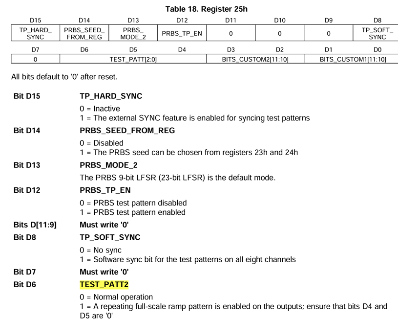

  • Hi Zeev,
    Could you please also tell us whether giving the ramp pattern as mentioned in the mail I sent you giving Test_patt2 shown below, also passed the test without any breaks.
