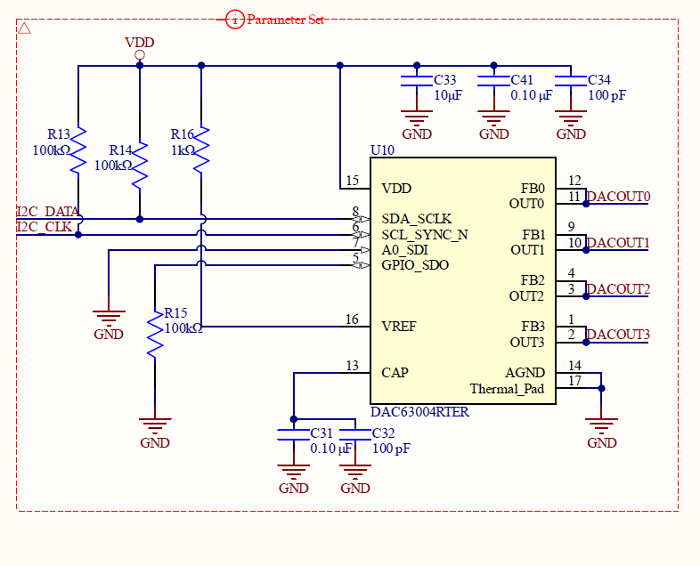

We have a fairly simple design based around a Nordic nRF54L15 SoC paired with a DAC60004 and connected via the I2C interface.  The interface is of course, very simple being SDA/SCL/VDD/GND.
We brought up our firmware using the Nordic nRF54L14DK evaluation board and the DAC60004 EVM and with proper jumpering on the DAC EVM (USB disabled), I2C selected, we were successful with bringing up the application with full DAC operation at the default I2C address (0x48).
We then moved to the prototype boards with our circuit design and we find no connectivity with the DAC.  The SDA line is asserted low at the START but no data is emitted and no clock appears on SCL.
The circuit differences between the DK/EVM and our prototype are that the A0 line is held low instead of high (address 0x49), The GPIO line is being held low through a resistor, and the SDA/SCL lines are connected to two different pins on the nRF54L15.   The firmware loaded on the prototype targets the new SCL/SDA pins.
We have confirmed connectivity and termination of the SDA, SCL, VDD, and GND connections on the prototype board for the DAC and the nRF54L15 and are atPatch_nRF54L15_schematic.png a loss as to why this basic connection is not functioning. Patch_DAC60004_schematic.png
We are attaching the nRF54L15 and DAC60004 portions of the schematic for reference and would appreciate your review and guidance as to what could be blocking this basic connectivity issue.

  • Hi James,  Thank you for the followup.
    First, thank you for correctly assuming I was referring to the DAC63004 device.  I was typing too fast and dropped it in the case title and problem description.
    Second, I am confused regarding the product specification and your comment suggesting the part we are using is SPI only. The part number for the device we are using is the DAC63004RTER.  The TI data sheet for the part (https://www.ti.com/document-viewer/DAC63004/datasheet) says nothing about being SPI only and if fact is titled "DACx3004 12-Bit and 10-Bit, Ultra-Low-Power, Quad Voltage and Current Output Smart DACs With Auto-Detected I2C, PMBusTm, or SPI".  This happens to be identical to the DAC63004W with the difference being that the DAC63004RTER is a WQFP package and the DAC63004W is a BGP package. Obviously swapping from the WQFP package to a BGP package isn't trivial and requires a new layout and differences in board assembly.

    Your pull-up configuration seems fine, and the only other visible connection is tied to the host pins. You mentioned that SDA is going low for a start condition, but you don't see any data or any clock.
    Are both I2C lines held high after power up, but before any commands are sent?
    After SDA goes low, does SCL also toggle low? Or does it remain high?
    The start of the I2C command is handled by the host, and all you should need are some pull-ups on the I2C lines for the open-drain control to work.
