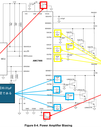

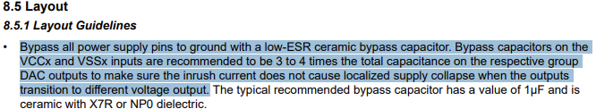

Hi team,
Based on the sentence listed on the datasheet, the bypass capacitors between power supply pins and GND should be 3 or 4 times the total capacitance on the respective DAC outputs.
When I see the typical circuit on the datasheet, there are total 30.01uF of the capacitors is connected to DAC outputs. Therefore pver 90uF of the capacitors should be connected to the power supply pins, but it is not. Why?
