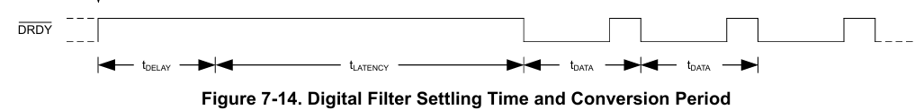

I have estimated the total processing time for the ADS112C14 in single-shot mode with MODE = 3 and OSR = 128. Figure 7-11 shows the latency and conversion time in continuous mode, but there was no  diagram for single-shot mode. In continuous mode with MODE=3 and OSR=128, as shown in Table 7-6, T_latency is simply T_delay + 258 µs+Tdatas and it appears that the processing time for the  single sample (125 µs) is included in this T_latency as pipeline prosessing. However, in single-shot mode, is it necessary to add the processing time for a single sample (125 µs) additionally to estinate the total processing time?
Or, as shown in Figure 7-11, can I assume that the processing time for one sample is included in the T_latency as shingle shot mode too?

    Your understanding is correct. The processing time for one sample is included in the latency time for single-shot mode.
