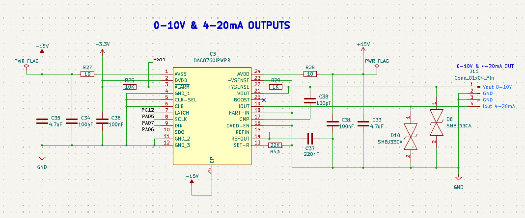

Hello E2E Experts,
I'm trying to make a process calibrator with the help of Claude AI.
Would you be so kind to scheck attached schematics?

    A few recommendations:
    Have C31 on the AVDD's pin side of the R28 resistor. The same recommendation for C34.
    ISET-R is recommended to be connected to a precision 15 kΩ resistor, you have 22 kΩ in your picture.
    C37, the CAP on REFOUT, is typically 100 nF as well, but 220 nF should be fine as well.
    If you have space for it, it could be worth adding a ferrite bead and additional diodes before D8/D10, see the below image:
