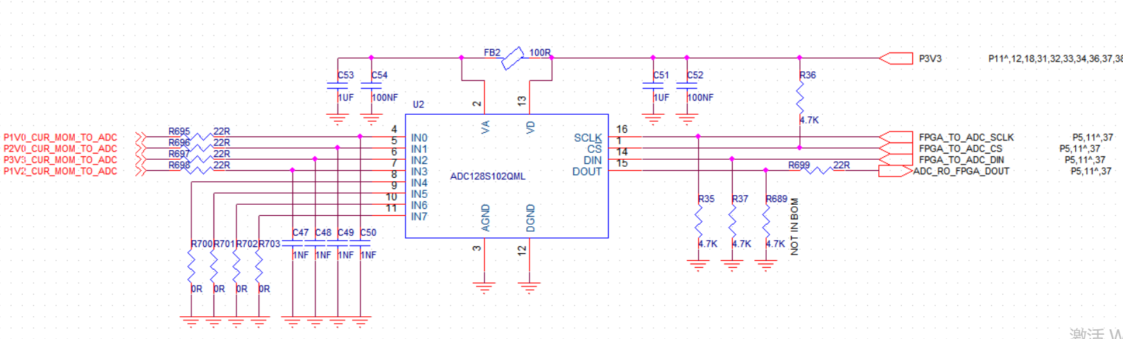

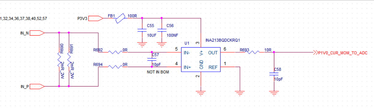

In one of our projects, we are using the TI ADC chip ADC128S102QML to read the analog signal from the TI current‑monitoring chip INA213BQDCKRQ1, which is used to monitor the current draw of the system power supply.
Our question is:
  • Can the ADC128S102QML directly read the analog output from the INA213BQDCKRQ1?
  • Do we need to add a voltage follower (buffer) in front of the ADC128S102QML input?
Please kindly review and advise. Thank you for your help.
