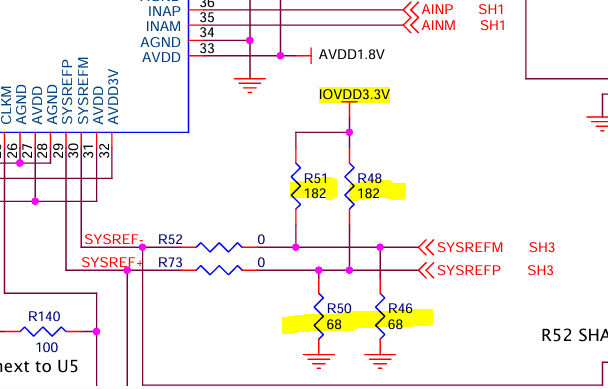

2. In the ADS42JBXXEVM-SCH_D.pdf , we have the following termination for the LVPECL SYSREF and SYNC:

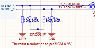

Why the use of IOVDD3.3V that is not used at all by the IC? Why isn't the IOVDD1.8V used in this case, with the resistors 100ohm instead to get the necessary Vcm of 0.9V? Something like below :

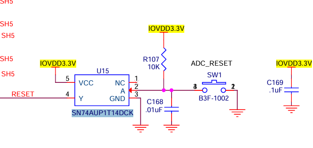

3. For the RESET pin, why the use of the inverter? Can't a simple pushbutton between the RESET pin and IOVDD1.8V suffice? image.png
    We recommend terminate the SYSREF based on the clock driver output termination methodology. The LMK04828 datasheet has certain specifications for the SYSREF and the associated termination voltage.
    Reset is active high. Push button, once pressed, connects to ground. Therefore, the inverter needs to invert the low signal to high signal.
    Hence my question. In the datasheet for the LMK04828, they only mention DC coupling but they never showed any real applied solutions, only AC coupling. And again, IOVDD3.3V is not even powering the output stage of the LMK04828 (the Vcg) so why they are being used to bias these signals? And if AVDD (AVDD1.8V or the AVDD3.3V?) is the power rail for these inputs, why are they not used in the biasing scheme?
    I think you misunderstood what I was saying :
                  IOVDD 1.8 V
                  [ PUSHBUTTON ]
                       +---------> RESET pin
                    [ Rpull-down ]
                      GND
    This is a typical circuit for active high inputs that I know. Why did TI include an active component (the inverter) on the dev board?

    Regarding the LMK04828 termination:
    You may post a related thread (i.e. + Ask a related question) Yellow Button above, and post a question on the LMK04828 design. I believe at the time the designer of this EVM utilized the recommendation from the LMK04808 termination
    https://www.ti.com/lit/ds/symlink/lmk04808.pdf
    Regarding reset circuit, all you need is an active HI signal. I do not have history of the original designer on why he/she used an inverter. Your circuit would work just fine. I would recommend a debounce circuit to avoid rining of the reset.
