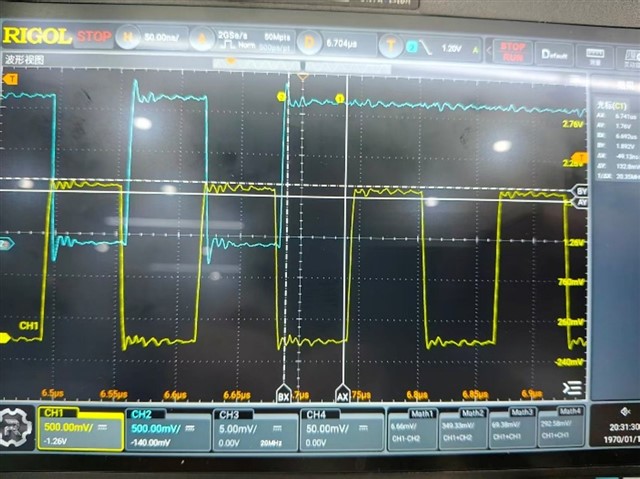

    I used the above configuration but encountered the following issues during testing:
    Configure the 0X14, 0X15, and 0X16 registers to output 0X4000 for testing, but there may be an issue of alternating 0X4000 and 0X4040 outputs. However, using all 0s and all 1s for testing is not a problem.
    SPI_Write(0x14, 0x04); // CUSTOM PAT[7:0] = 0x04
    SPI_Write(0x15, 0x00); // CUSTOM PAT[15:8] = 0x00
    SPI_Write(0x16, 0x48); //Both A/B channels are RAMP (TI E2E only tests A channel with 0x08)
    The waveform tested after outputting the 0X4000 test configuration: DA5 has all zeros, and DA6 is theoretically 0b10000000 → 0b10000000,
    But in reality, it does cycle like this: 0b10000000 → 0b10001000 → 0b10000000. Below is the waveform diagram of DA6.
    The waveform for capturing DCLKIN is as follows
    With the corrected
    Constant Pattern config (0x14=0x00, 0x15=0x40, 0x16=0x6C), for output value 0x4000
  • Hi Sambasiva,
    1.During ADC testing, no data sampling was performed. Set the DCLKIN frequency to 8MHz and expect to output the same 8MHz DCLKOUT and 2MHz FCLK with a duty cycle of 40-60%; The test input data is (0x14=0x00, 0x15=0x40, 0x16=0x6C), and the expected DA output is a fixed 0X4000.
    Main issue: Currently in data testing mode, the duty cycle of FCLK is incorrect (mostly high level), and a cycle of high level will occur at low level moments; The DA output is a loop of 0X4000 → 0X4040 → 0X4000 → 0X4040.

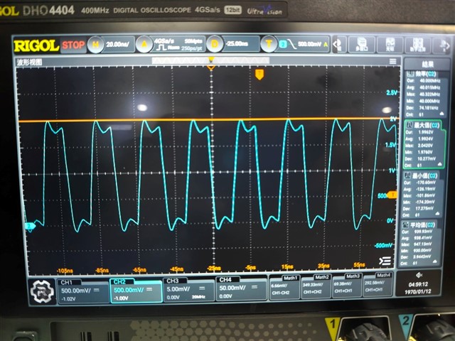

    Figure 1: FLCK (blue) and DCLKIN (yellow) waveforms
    Figure 2 FLCK and DA6

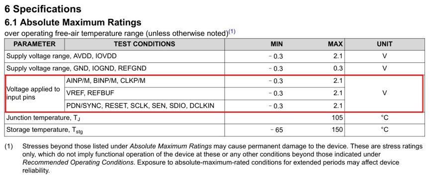

    Figure 3 Hardware Design Schematic
    There is no internal reference used in the register configuration, but an external reference of VREF is used. However, REFBUF and AVDD are powered on together without a 2ms delay. What impact does this have on the ADC state? Is it related to the phenomenon we encountered?

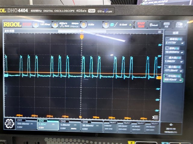

    When the ADC is not working, the DCLKIN clock signal level output by the FPGA is 1.8V, and there is no overshoot or ringing. After the ADC is powered on, the DLCKIN level is pulled up to 2.1V (the DCLKOUT and FCLK levels are also the same). Subsequent adjustments to the FPGA program have reduced the IO drive capability from 16mA to 4mA. The overshoot issue has been improved, but the ringing is still noticeable. Is this phenomenon abnormal? If there are any abnormalities, can you provide solutions or optimization ideas?
    Figure 4 Overcharging and Ringing of DCLKIN
    Will DCLKIN overshoot slightly beyond the pin range of 2.1V (or -0.3V) cause logic problems and affect digital signal output?As shown in Figure 4.
    Does the data manual require the logic level of DCLKIN to be set to 0 below 0.1V and set to 1 above IOVDD-0.1V? Tests have shown that during the ringing process, the voltage level may sometimes be slightly lower than 1.7V (with IOVDD set to 1.8V) or higher than 0.1V. Will this cause logic problems and affect digital signal output?

    1. In our testing, the DCLKOUT logic read by the FPGA is normal. Can this indicate that the DCLKIN read by the ADC chip is normal? Can the abnormal output of FCLK and data indicate that DCLKIN is abnormal? Or is there any other reason?
    2. The level and jitter requirements for DCLKIN are very strict in the data manual. If they are not met, will it have a significant impact on the data output? Does it match the problem we encountered?
