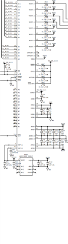

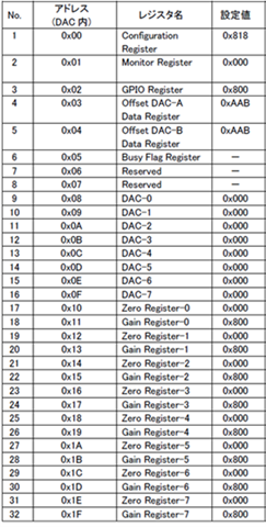

  • Hi Erin, thank you for your prompt reply.
    I have attached the peripheral circuit diagram for the DAC.
    I have also attached the register settings.
    There were no issues regarding the data itself.
    When the setting is 0x2AB (equivalent to -2.5V), the offset becomes 0V.
    After that, the output matches the settings, and the gain is correct.
    Therefore, we are currently using the value 0x2AB without any problems.

  • Hi Osamu,
    Your schematic image is too small for me to read unfortunately, it may have been limited by the forum.
    With an OFFSET DAC code of 0x2AB, you should read around 0.83V on the OFFSET DAC output (pin 12).
    I believe the discrepancy could be found in the supply sequencing. If the supplies are not sequenced correctly, it's possible that the negative bias could not be fully turning on. If you go through the range of DAC codes, do you get the correct output?
    Erin
    I am resending the circuit diagram in a clearer format.
    Could you please take a look at it?
    Thank you for your continued support.
    Osamu

  • Hi Osamu,
    Your schematic looks fine as far as I can tell. Let me know if you run into any other issues.
    Erin
