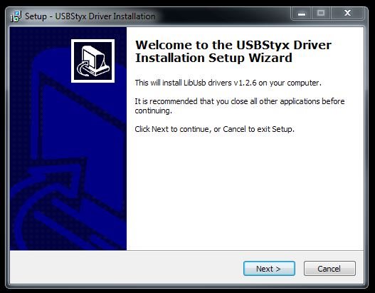

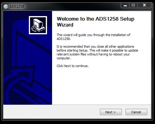

    After attempting to load the ADS1258EVM plugin in ADCPro, does the MMB0 re-enumerate to "USBStyx"?
    ...If this is failing then the USBStyx driver many not have installed properly. Since it gets installed with the ADS1258EVM plugin, you may need to try re-installing the ADS1258EVM plugin. Here is the link:
    ftp://ftp.ti.com/pub/data_acquisition/ADCPro2/Plugins/ads1258-adcproplugin-2.0.0.exe
    You should see two setup wizards during installation:
    If re-installing the software doesn't fix the issue, I'll be glad to send you a replacement ADS1258EVM-PDK.
