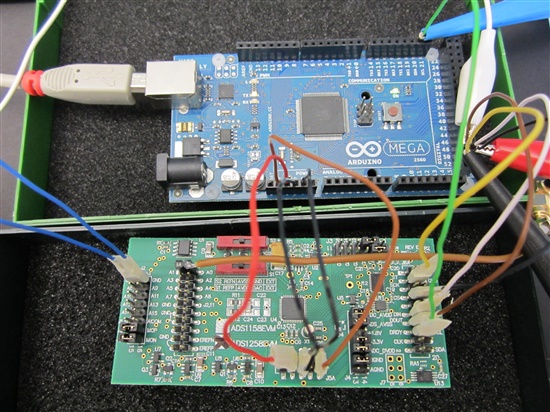

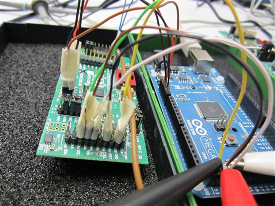

    Here are the screen shots of my Electronic setup and Oscilloscope:
    Figure1: Electronic Setup (Top)
    Figure2: Electronic setup (Side)
    Jumper settings and wiring:
    1)  J5.3 to 5V on arduino
    2)  J5.5 and J5.6 to GND
    3)  J5.9 to 3.3V
    4) J6.3 to D52 (SCLK) on arduino
    5)    J6.7 to D53 (CS) on arduino
    6) J6.11 to D51 (MOSI) on arduino
    7) J6.13 to D50 (MISO) on arduino
    8) J6.15 to pin2 (INT) on arduino
    9) A0 on J1 is connected to +-2.5V of signal generator (To make things simple to understand I just connected one channel)

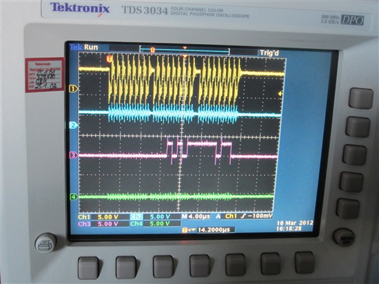

    and screen shot from Oscilloscope:
    Figure3: Oscilloscope Screen shot
    Channel1: SCLK (Yellow:  last 24 clocks)
    Channel2: DRDY (Blue-HIGH)
    Channel3: DOUT (Pink)
    Channel4: CS (Green-LOW)
    By changing the SPI frequency (SCLK)  from 125KHz to 1MHz (Master clock=16 MHz) and Mode=11( Cphase=1, Cpol=1) I was able to see something on DOUT. It gives me a constant value of 15F6(HEX) or 5622 (Decimal). I realize my clock is also not so clean.I connected a 50 Ohm resistor before applying to SCLK pin  .Is there any other remedy for it?Also I shorted MUXOUTP and MUXOUTN to ADCINP and ADCINN respectively. I did not use any buffer amplifier.Is it fine? Moreover I set Bypass=0 in Config0 for it.
    The DRDY doesnot change value and it is always high. In my code I changed the DRDY from LOW to HIGH.Now I am continuously reading the data, since DRDY is always high.

    As you can see in figure3, I only get two data bytes 15F6Hex or 5622 in decimal, and no status byte while I have set STAT=1 in config register0.Otherwise I could poll for NEW bit. Should I use Start pin to control the loop?

    After disconnecting the pins ST(start) and GPIO0 on J3, it seems I am getting something from ADS1258EVM board but not sure if it is correct.
    I have further connected START pin on J6A on the board to one of interupt pins on arduino, as well as CLKSEL to GND. Moreover SPI mode is changed to 0 i.e Cphase=Cpol=0.
    To make things simple, I am applying analog input voltage of +-2.5 V on the Channel1(A0) only while others inputs (A1-A15) I have disbaled.(MUXSG0=0x01 and MUXSG1=0x00).I will use the other inputs later when i get the correct results.
    I am reading the channel ID=8B and all other registers correctly, which means my board is working.

    When using channel data read format, you need to make sure that you are reading the data completely before the next DRDY pulse, or the data returned will be corrupted by the result of the next result.  You also need to be sending 32 clocks, so I think there is something missing in your code. If you are in fixed channel mode (and not scan) then 24 clocks would be appropriate and no status byte is sent.

    Thank you very much for your answers.It seems I am getting the complete data now.
    You are right, there were some bugs in my code which I have corrected now. I was sending only 16 clocks instaed of 40 clks to converter.
    The converter works well for one channel and I can see correct data coming from COM port. But when I enable all 16 channels with MUXSG0=FF and MUXSG1=FF, I see the converter skips some channels and sequence is also not correct e.g. CH0, CH7, CH15, CH4, and so on. May be there is some delay in my loop perhaps.Don't know yet. I will check it later.
