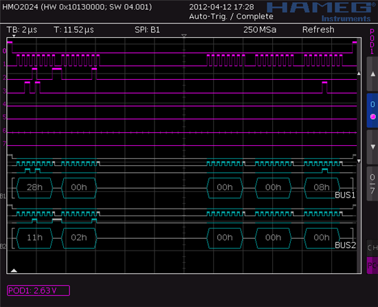

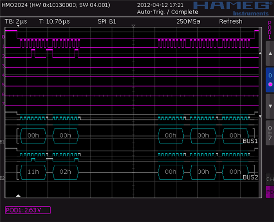

  • Hello!
    That's right, i want to read the register using the rreg-command and 'dummy' is a 0x00. Until now I don't store these data because I just wanted to see, if the registers contain the right values.The debugger window shows me the same values the analyzer does.
    Here you can see two screenshots of the data to and from the ADS1255.
    0 -> CS
    1->SCLK
    2->MOSI
    3->MISO
    The data on MISO seem to be random numbers but I logged it (sent the data to the pc and stored them with a terminal program) and all the data consist of "0x00" "0x08" "0x28" "0x40" and "0x94". After a reset of the MC and the ADC the SPI showed the same behavior just with different numbers like "0x50"....

  • J.S.,
    Slow down your SCLK frequency.  See Figure 1 of the datasheet for t1.  The maximum is 1/4th of the master clock frequency.
    Bob B
