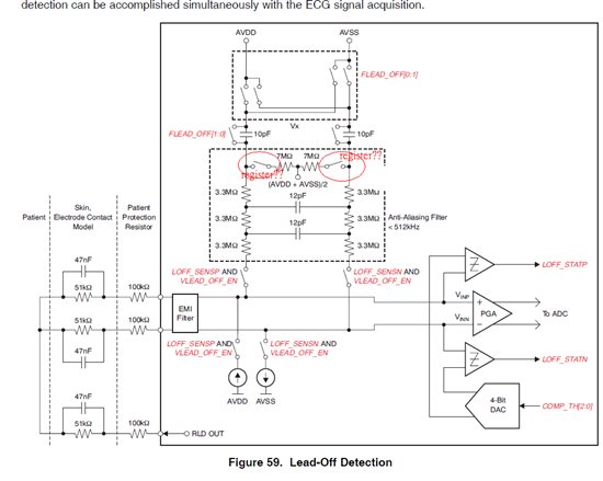

hi:
I have tree questions:
1.
the datasheet paga 63(Figure 59. Lead-Off Detection) , How do I set the register to Red circle?
2. How do  setup  the  register  for AC Lead-Off  Detection(Figure 59)

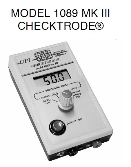

3.
I can desing the ads1298 Register function to Impedance Meter desing?
Example product : MODEL 1089 MK III  CHECKTRODE®
Various readings indicate the following:
5 K or less – excellent skin prep: proceed
with recording and expect good results.
5 – 10 K -- good skin prep, but expect
some noise in the recording.
10 – 30 K -- fair skin prep. Contact
impedance may decrease with time, but for
best recording quality, electrodes should be
removed and skin re-prepped.
Above 30 K -- bad skin prep. Even slight
patient motion will cause. Electrodes must
be removed and skin re-prepped.

    We'll get back to you as soon as possible on your first two questions.  On your third question though, I'm wondering exactly what it is that you are trying to do so I am hopeful that you can clarify your situation a little for me.  Are you asking if the ADS1298 could be used as a replacement for the Checktrode product?
  • I want to calculate the ADS1298's EEG impedance for single of quality
    EEG impedance Detection
    Above 30 K -- bad skin prep.  Electrodes must
  • Hi Yan Jia-Hong,
    The 7M ohm switches that you referenced in your original post and not individually controlled using a specific register bit. They are automatically enabled when AC lead off is enabled used to set the midpoint of the power supplies as the common mode point for the AC lead off excitation signal. This AC signal is derived by the 10M ohm resistors (three sets of 3.3M ohm resistors) switching in and out to pull the input line to the negative and then positive power supply at the excitation lead off frequency.
    Using lead off to calculate skin impedance has been discussed by other customers on the forum. Internally, we have done some testing using series resistance and a patient simulator to emulate an eroding electrode. An application note on lead off detection, including testing using AC lead off is in final stages of edits and should be online within the month.

  • I got the Application Report SBAA196. I follow the figure 2 to connect electrodes. I want to get the results like figure 9. Can I get the same cure if I put the different positions for the RLD pin? How do I set the registers?
  • Hi Yan,
    Could you elaborate a little more on what you mean about the different positions for the RLD? RLD is used to set the operating point, and if you are changing the RLD signal source or how it is derived, you will want to wait seconds while the point is set and system is stable to avoid as much DC baseline drift as possible. You will need to use AC leadoff in order to monitor electrode impedance similar to how we have done in Figure 9. Careful digital filtering will need to be done to remove the ECG away from the AC signal in order to view the true amplitude of the excitation signal. Keep in mind, in a true ECG patient/simulator system, it is very probable that the input cables and electrodes attached to the patient are going to carry a changing capacitive element as well.
