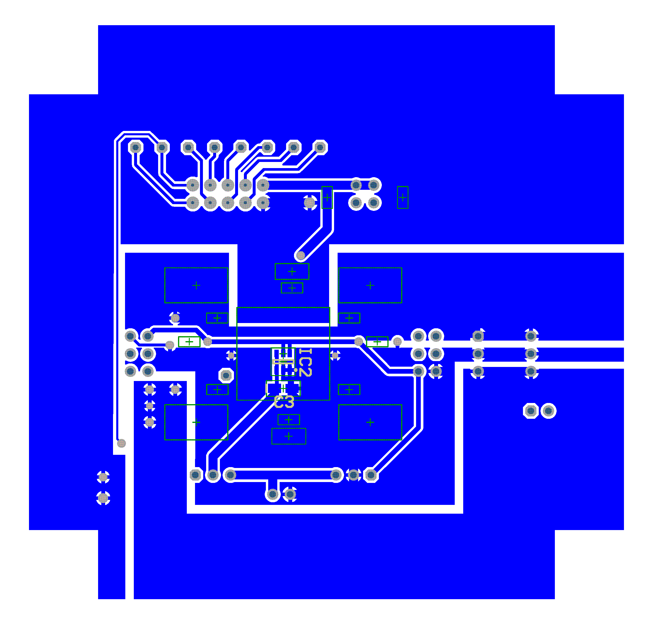

- The DAC board uses split AGND and DGND ground planes connected near the DAC (<1cm=0.4")
Here's the schematic of the DAC Board:

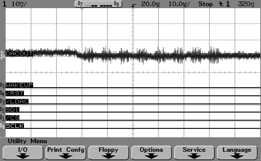

1. I have - in my opinion quite serious - SPI interference in my DAC output signal. Figures 2 to 4 illustrate this. See figure descriptions for further details. Can anybody please tell me what to do to get rid of this? Has anybody reached better performance?

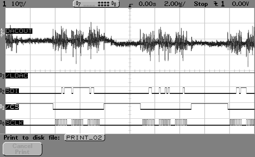

Figure 2: What you see is DACOUT3 as well as some digital control signals as descripted in the figure. DAC3 is performing a -16LSB step on the 4th rising edge of \CS. The code transition is from 0x7FC0 to 0x7FB0, which is near midscale (0V). As you can see, the DACOUT3 signal is quite serious corrupted by the SPI communication signals. Most prominent one is SCLK but also the \LDAC spike (which is currently not used but inserted for demonstration purposes) causes a spike in the output signal.
Figure 3: This is just a zoomed version of Figure 1 which shows clearly the relationship between the SPI signals and the 'noise' at the output.
Figure 4: Another more zoomed version shows that the \CS signal causes an interference at the output, too.
Any suggestions for removing these spikes? I took care to route any high speed digital signal within the DGND plane. Supply cables are about 15cm = 6" in length. The output signals are measured with the probe connected directly to the pin header which is about 2.5cm = 1" away from the DAC. No load is connected to the DAC.
