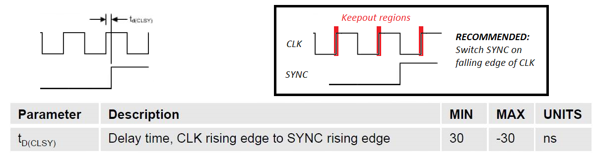

    I think we found an interesting thing today: We measured the time in between the Sync signal rising edge and the main clock rising edge. and we found something very close to 10ns, which is the T(hold) and T(setup) time of the ADS1282 chip.
    We then moved the Sync signal rising edge towards the main clock falling edge and it seems now to work. It is still under investigation, but it may be a lead.
  • I have been working on the exactly sync problem for 1 week and finally figured out that there is a design bug inside ADS1282 hardware ---- when Sync line is synchronized with rising edge of master clock of A/D (normally designer use FPGA to generate Sync signal in a state machine with the same A/D master clock),even Sync signal is pulsed low for many master clock and becomes high for ever, ADS1282 will miss Sync line rising edge, and will NOT re-sync all ADS even in single pulsed mode, which means that after rising edge of Sync, the DRDY still continuously come in single pulsed mode (default mode), instead of become high for about 63mS. This is most likely caused by some state machine inside ADS1282 which check Sync line directly without first synchronized it with master clock which causes that statemachine enters wrong state due to insufficient set up time of sync (even sync actually is hold high forever). Many design for FPGA state machine makes same mistake, in which state machine uses un-synchronized input signal (eg. Sync signal) as input in state machine for next state.
    I hope that TI can correct this problem in its future production. As the other engineer, I spent so much time before figuring out the problem. After I put many buffers to delay Sync inside the FPGA so that it will not around the rising edge of master clock, it is now working properly. Alternative may be using negative edge to generate Sync clock.

  • Hi Martin,
    I do have an update on this issue...
    There is a synchronization issue when the SYNC rising edge aligns with the CLK rising edge. Use the following timing guideline to avoid this condition:
    If you don't have the ability to control when the SYNC rising edge occurs, then I would recommend toggling SYNC pin twice (low-high-low-high). I've found that this is usually sufficient to resolve the synchronization issue.

    The SYNC bit in the CONFIG0 register only sets the synchronization mode (pulse- or continuous-sync mode) for the device. To perform the synchronization event, you'll need to issue the SYNC SPI command (0x04 or 0x05, in pulse-sync mode ONLY) or toggle the SYNC pin (in pulse- or continuous-sync mode).
    In continuous sync mode, if you issue a sync that is out of phase (not a integer number of the data rate), you'll still see /DRDY pulling; however, you will only read 0 data until the data is settled (63/fdata conversion periods later).
