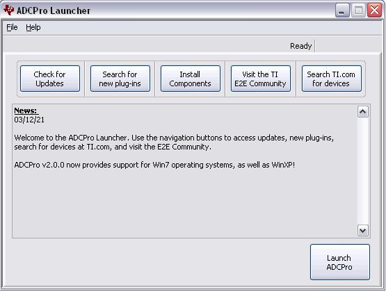

    For ADCPro version 2 we added a Launcher application that should take care of downloading, installing, and updating plug-ins for you. Did you use this application to apply these changes? See a screen cap of the application below. This path should be relatively automated, even with a transition from v1 to v2.
    1. Go to www.ti.com/adcpro
    2. Download the ADCPro Launcher
    3. Using the Launcher, Download & Install ADCPro
    4. Using the Launcher, Download & Install the ADS1281 Plug-in

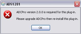

    We changed a number of things about the way that plug-ins are maintained and updated through the 1.2.2 to 2.0.0 transition that keeps the 1.2.2 updater from being able to acquire updates to move to 2.0.0. You should have seen the error below while trying to install the newest version of the plug-ins, and we can try to revise this message to indicate appropriately that users need to go to www.ti.com/adcpro and download the new client rather than using the updater. Thanks for your feedback.

    The links in 1.2.2 to the plugins don't work so there is never an opportunity to see the message to download ADCPro 2.0.0.

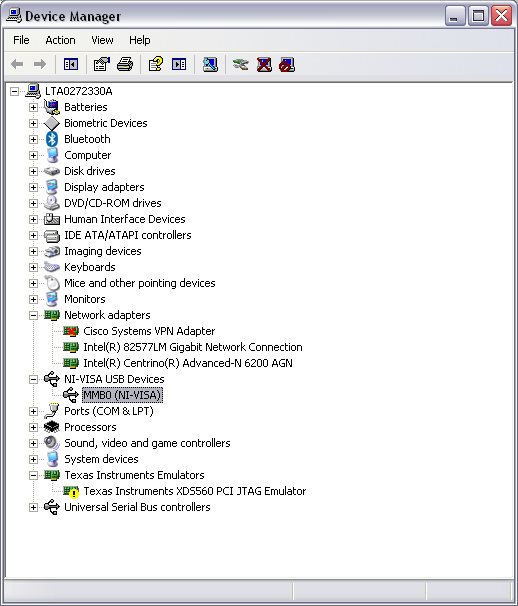

    The ADS1278 and ADS1281 both use the same driver - so if the ADS1278 works it's not likely a driver issue. None-the-less, the driver of interest for loading the firmware should be recognized as "NI-VISA USB Devices - MMB0 (NI-VISA)" in the Device Manager, shown below:
    If somehow Windows enumerates the ADS1281 differently than the ADS1278 it will be recognized as "NI-VISA USB Devices - TMS320VC5509A (NI-VISA)." Investigate this and let me know your findings and we can go from there to try to rectify any driver problems.

  • Strangely enough, according to the diagram in Figure 4, there was a missing jumper.  The software installed the missing USBStyx driver and it is now working.  I still have a problem, though.
