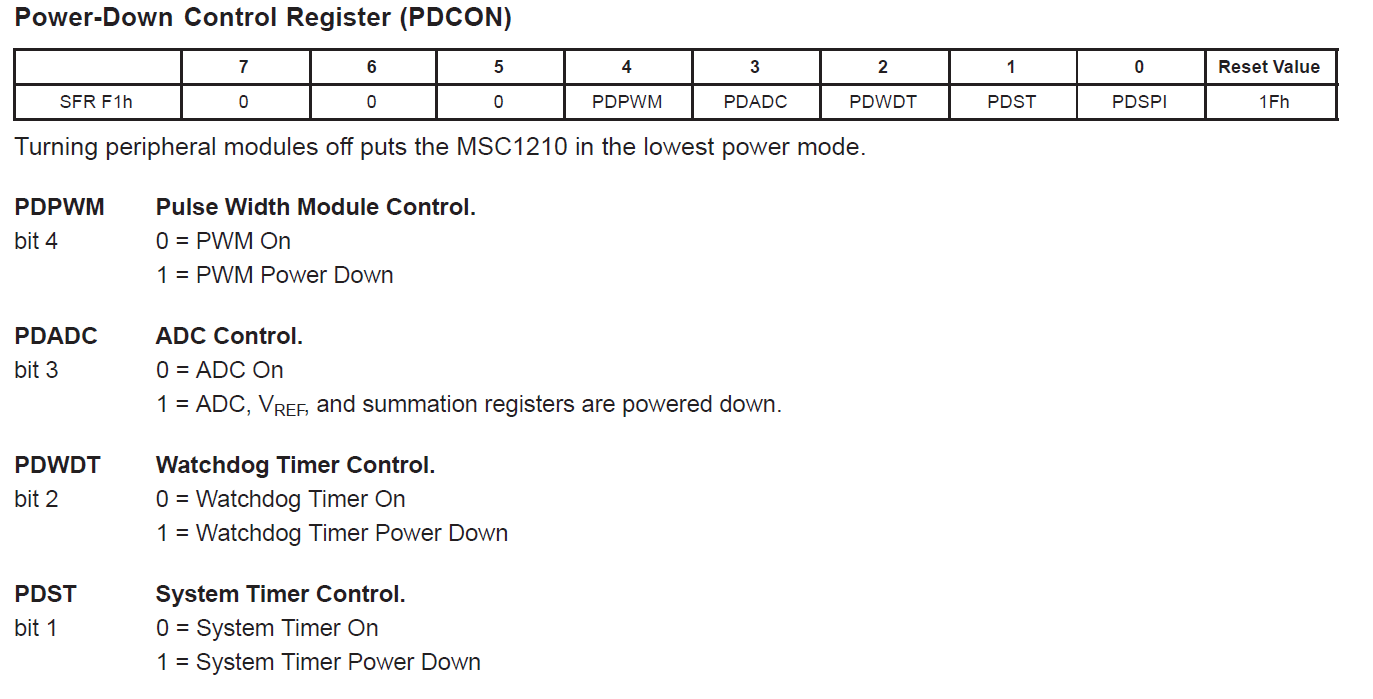

  • Ramesh,
    The only example code we have is in the location I pointed to on the ftp server I gave you earlier.  I also stated that the code snippet you sent doesn't initialize the timer.
    First of all you will need to turn on the peripherals you want to use.  In your case PDCON must be 0x15.  Neither your current code or your commented code show that you are turning on both the ADC and the Timers.
    Second problem I see is that even if PDCON is set properly the Timer0 interrupt enable flag is not set as it is commented out.  The timer enable is ET0=1 and the timer start is TR0=1.  In your interrupt routine for the the timer I would reset the interrupt flag before re-enabling the global interrupt enable.
    You could be having another issue as well.  If you do not service the ADC interrupt properly or re-enable the interrupts at this point the timer will never trigger an interrupt as the ADC interrupt has a higher priority.

  • Ramesh,
    Today is a holiday in the USA, so I will look in more detail tomorrow.  PDCON with default setting turns off the timer peripheral, so the timer should not work using 0x1F. A zero bit turns on the peripheral and a 1 turns it off.
    Bob B
  • Ramesh,
    As I stated before, you must make sure that the PDCON bits are set correctly.  What is very confusing is if the timers are not enabled (PDCON bit 1 low) you should not have been able to see anything work.  This is curious.
    You do have a code issue however, which may be causing your main problem.  This is regarding the interrupt enable. In setport1() you set IE = 0xF0, which enables the interrupts for the serial port and sets the global high.  Later you set IE = 0x86 in Timer0_init() which turns on the Timer0 interrupt, but turns off the Timer2 interrupt used for the serial communications.

  • Ramesh,
    It is possible that I'm misunderstanding what you are trying to do.  As I do not have a schematic, I can only guess.  Up to this point I was assuming that you were strictly free running the timer0 updating your variable 'timer_0_overflow_count.'  I also believe that I made an error on what I told you to use for IE register based on your code assignment and not on the other register settings.
    Let's take a look at what registers must be set when using the timer0.  First off all the timer power must be turned on by setting the appropriate bit low in the PDCON register.  Other registers that affect the timers are CKCON, TCON, TMOD, TH0, TL0, TR0, TF0, and IE.
    CKCON adjusts the count divider, and is not critical to operation.  TH0 and TL0 set the counter start point.  The timer will count up until it overflows, so the start point is not critical to the operation.  TF0 gets set by as a flag by the timer0 overflow, and you initialize as 0 (reset) and re-initialize to 0 in the interrupt routine which is correct.  Timer 0 operation must have the TR0 high and it is set high both in initialization and the interrupt which is correct.  TCON contains both the bits for TR0 and TF0, but also determines the type and method of the interrupt detection.
    Here is where we start to have a problem, as you have this register set to 0x04 which sets INT1 to edge triggered (high to low).  Timer 0 uses INT0, so maybe the correct bits are not set in this register.  TMOD sets the timer mode controls.  In your code TMOD is 0x19, where bits 3-0 are timer 0 mode controls.  With bit 3 set, the timer 0 will only run if TR0 is high, and INT0 is also high.  This means this timer must have hardware interaction to operate.  Do you have a control signal connected to the INT0 pin (P3.2)?  And is it logic high?  Do you want this timer to run this way, or do you want it to free run with software control only?
    Lastly the IE register.  This is set to 0x86, which globally enables the interrupts and enables the INT1 pin and enables the timer 0 interrupt.  It does not enable the external INT0 interrupt which is required by your setting of TMOD.
    In Timer0_init() if you want the timer to just free run the settings should be:
    TMOD = 0x11;
    IE |= 0x82;  // also set in the interrupt service routine
    In Timer0_init() if you want the timer to run based on the INT0, TCON should be set as desired and the other settings should be:
    TMOD =0x19 ;
    IE |= 0x83;  // also set in the interrupt service routine
    This is assuming that I have the correct idea on what you are trying to do.  If my assumptions are not correct, please explain how you intend on using the timer.
    Bob B

    so,  when can i set PDCON=15, adc uart 0 fine, when disable adc using PDCON=0x1d when Timer isr and UART 0 working fine,
    i have used (CLR EAI) bit  it didn't control properly in adc, and timer isr this is control one time only.
    i want more details of this.

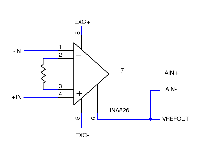

    NOTE:
    1) my sensor Load-cell, i have apply 5v power supply its work fine,ADC count stable(input 1mv upto 20mv), but 12v power supply apply its (input 2mv) when adc
      count cant stable.7000 count jumping. what appan please update me.
    Thanks and regard,
    Ramesh k
  • Ramesh,
    You cannot exceed the absolute maximum voltage specifications.  If you excite your load cell with 12V, the balance point of the bridge is 6V which is greater than the supply of the MSC1210.  In this case the ESD cells will turn on and conduct current that can damage the MSC1210.  You must also make sure that the input is within the common mode input range of the MSC1210 analog inputs.  This is determined by the PGA setting used and the AVDD supply.
    Bob B
  • Dear Bob,
                          I am not clear above this point, i have using MSC 1210 power supply AVDD=5V ,and DVDD=3.3v and my loadcell operating voltage 5V to !2V(EXE-,EXE+)
    so i have given 5v/800mA for EXE+,EXE-,  zero scale is 1.2 mv then works fine, same i have used 12V/800mA power supply  zero scale is 2.2 mv but my count not stable.
    we have used industrial so required 12v (EXE+,EXE-). what can i do?
    i thing,  we will change Low pass input resistor 1K replace to higher value. its possible?
    Ramesh k
  • Ramesh,
    As I have not seen a schematic, so I can't speak directly to your filter.  If you want to use a 12V excitation to the load cell, you will need to adjust the output in some way so that the + input to ground, or the - input to ground does not exceed the AVDD supply of the MSC1210.
    If you think of the load cell as a variant of the Wheatstone bridge, strain on the bridge affects the resistance value of the leg in the bridge.  In the balanced, or no load state, the bridge is simply two parallel voltage dividers that behave the same way.  The difference between the measuring point (+ and -) has zero, or close to zero difference.  However, there is a voltage common to each of the inputs relative to ground.  As each resistance in the bridge is equal, the common voltage relative to ground will be half of the excitation voltage (or 1/2 of 12V which is 6V.)  In this case, each of the analog inputs may have 0V difference between them, but has 6V that is applied in common to each.  6V is greater than the AVDD supply.  The absolute maximum analog input is specified to be 300mV above the AVDD supply.
    To use an excitation of 12V, you will need to bring the common mode voltage below AVDD and withing the range of the PGA of the MSC1210.  The best region for the common mode voltage is mid-supply of AVDD (or 2.5V.)  To accomplish this, you will need some type of instrumentation amplifier, like the INA826 that will accept the higher common mode voltage, and set the output relative to a reference.  The reference can be the REFOUT of the MSC1210 at 2.5V.
    Bob B

                         How are you? I am fine. sorry for delay. I have used PDCON=0x15;   i am try to control adc using AI=0,EAI =1 adc working. but AI=0,EAI =0 adc cant control or off.
    Note:
    1) i am using UART0 isr, its working fine before init this register PDCON=0x15;  When i was int PDCON=0x15  after adc works fine, but UART0 isr and timer 0 isr
    affected.
    2) When i have init adc PDCON=0x15, All vector ISR should not work, its very clear,  this problem also we faced on timer 0 isr. now i have tested UART 0 ISR also.
    3) when i have init PDCON=0x15 before All isr working fine, after init PDCON=0x15 All isr cant work. after i was disable PDCON=0x15; but all irs cant work..
    4) you are say  set/clear AI=0,EAI =1 and control( on/off) adc. its cant work. so please update what can i do? please update me.

    I recompiled the code with Keil, and it works fine.  I think that maybe you have something set wrong in Keil.  I've attached a zip file that contains the project files for both Keil and Rasionance.  Perhaps you can identify a setting that is different than yours.  At this point I'm not sure what more I can do for you in providing further help in getting your code to work.
    0172.MSC_Example.zip
    Bob B
  • Dear Bob,
    MSC_5F00_Example.zip  this source code working fine, But  you have used UART 0 using printf statment , i want transimite through polling method using SBUF0,
    like this  SBUF0='A'; while(TI_0 == 0); TI_0 =0; poling method transmit cant work. please update me.
    Thanks and regards,
    Ramesh k
  • Ramesh,
    Your original problem stated that the uart, timer and ADC could not operate at the same time.  I demonstrated that this is possible.  I also told you that I do not have a full version of the compiler, so I cannot do extensive code operations.  Built in functions, like fprint() are available to me as they are in the standard library.
    As far as building routines that function outside of the interrupt, and yet use interrupt flags only confuses operation.  So in this case you cannot use polling and interrupt functions at the same time.  Turning the uart0 interrupt off (bit 4 of the IE register) would be appropriate.
    Remember that when you turn off internal interrupt operations and use polling, you have eliminated the priority interrupt system.  This means you may have to disable lower priority interrupts when higher priority functions are in operation otherwise interrupt flags may be missed, misinterpreted, or ignored.
    This may have been your original problem.  It is up to you the programmer to decide how your system is to function.  I demonstrated that all three operations can work simultaneously.  If you want to devise your own method, that is fine.  However, I do not have the software to write advanced code of the nature and operation you desire.  You will have to debug your system and discover where your software is failing.
    Bob B
  • Dear Bob,
    yes, your above point is correct, because i have used  SBUF0='A'; While(TI_0==0); TI_0 =0; TI_0 flag is cant set properly, after i remove while condition and replace delay
    its works fine. SBUF0='A'; delay(50); TI_0 =0;  this is not right way, so please update me how we can fix it.
    Ramesh k
  • Ramesh,
    Sometimes actions within a comparison can be misinterpreted.  The TI_0 flag should get set once the buffer has been written.  Try a different comparison with the while to see if the action completes.  For example:
    while(!TI_0);
    Bob B
  • Dear Bob,
                            I had solve all the software bugs, Very very Thanks Dear Bob,  i have enable  axillary interrupt AIE =0x20 that is affected,

  • Ramesh,
    I already answered your analog questions in earlier posts.  I suggest that if I have not answered a specific question you start a new post with just the analog questions so we keep specific topics together.
    To quickly address once again, you cannot exceed the common mode voltage specification for the analog inputs.  The DC voltage from the analog + input and the - input cannot exceed the AVDD supply voltage.  This input can be measured from each input to ground with your load cell connected.  There are some further restrictions as to the limit of this range (may be less than AVDD) when gain is used and the internal buffer is also used.
    For example, with 12V excitation, the balanced bridge state will be 1/2  the excitation voltage (6V).  6V will exceed the 5V AVDD supply, and will draw excessive current (through ESD protection diodes) and can damage the MSC1210.
    The solution is to lower the excitation voltage, or use the circuit I gave in the earlier post.
    Bob B
