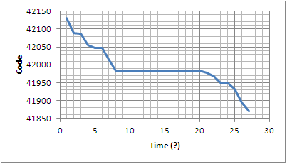

We are using an ADS8319 and I am seeing a kind of "plateau" effect in the digital values read from the device.
For example, for a slowly declining input voltage signal, the digital values will also slowly decrease until they reach a value where the lower byte is equal to 0xFF; at this point the value gets stuck for between say 2 and 7 subsequent samples. After being stuck for this brief period, the digital values will return to a normal, expectedl slow decay, matching the input voltage.
Here is an example of a contiguous set of A/D digital values to illustrate the problem:
A493
A469
A468
A448
A43F
A43F
A41F
A3FF
A3FF
A3FF
A3FF
A3FF
A3FF
A3FF
A3FF
A3FF
A3FF
A3FF
A3FF
A3FF
A3FA
A3F0
A3DE
A3DE
A3CD
A3A7
A38F
The repeated value is always 0xFF in the low byte; the high byte varies, so there are several places where the digital numbers form the plateau.

    Thank you for the quick response! However, we were able to fix this problem in the following way:
    Our PCB has separate analog and digital ground planes. We initially had the ADS8319's pin 5 tied to our digital ground, which produced the results that I posted above. When we moved pin 5 to analog ground, this "plateau" effect disappeared completely. So in the original configuration, the reference voltage source and the A/D were not grounded at exactly the same spot. A ground noise spike at the wrong time must have caused the SAR to step over a bit and never recover?
