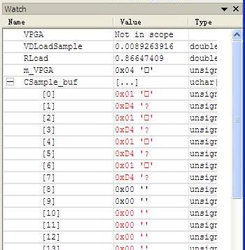

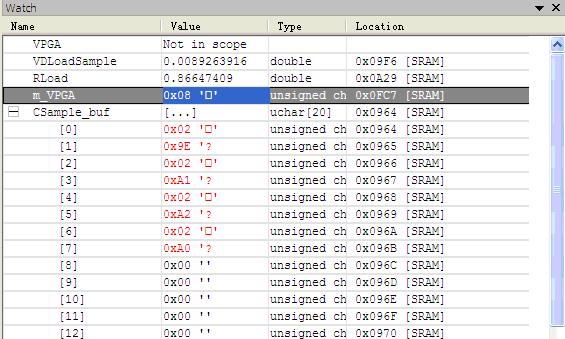

My problem is: circling through two channel,
When I set PGA =0x04,one channel data out is 0x01D4,seems correct,
When I set PGA =0x08,data out is wrong,
       VLOAD10MAsample(m_VPGA);//first channel
       IRessample(m_IVGA);//second channel

    - Can you please clarify the PGA gain settings, in other words what is meant by PGA= 0x08h or '1000'?  The PGA gain is controlled by the SYS0 register where bits 6:4 (3 bits wide) of the SYS0 control the PGA gain :
    000    PGA=1
    001    PGA=2
    010    PGA=4
    011    PGA=8
    100    PGA=16
    101    PGA=32
    110    PGA=64
    111    PGA=128
    - Can you please clarify the conversion results obtained from the 10mV differential input voltage ?  The conversion results shown on the description are hex 0x01D4 (16 bit wide) which do not seem to be correct.  The device is 24 bit converter; a 10mV differential input at gain of  0x04h or gain =16 should provide a 24 bit result close to x8C3F3Dh.
