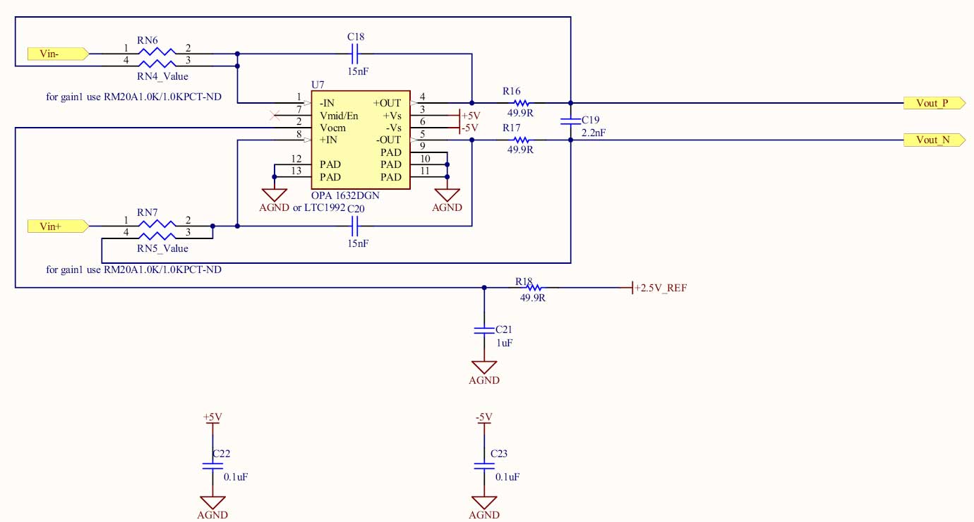

Hi, we're seeing random failures of ADS1274 converters in our application. There does not appear to be any problem with supply voltages going out of spec, and our drivers are very similar to the eval board except we have Schottky diodes to prevent signals from going much below AGND. The ADC talks to an FPGA. We don't see any correlation with temperature- we've run it up to Ta > 60°C in our environmental chamber several times. We've set scopes to capture transients on the supply lines and don't see anything odd.
In this set of boards, the therm pad is floating and we don't deliberately sequence the supplies (they are derived similarly to the eval board).
The symptom is that one channel fails (for example, channel 2), producing a "railed" output equivalent, though the digital output and analog inputs look fine.
Any ideas?

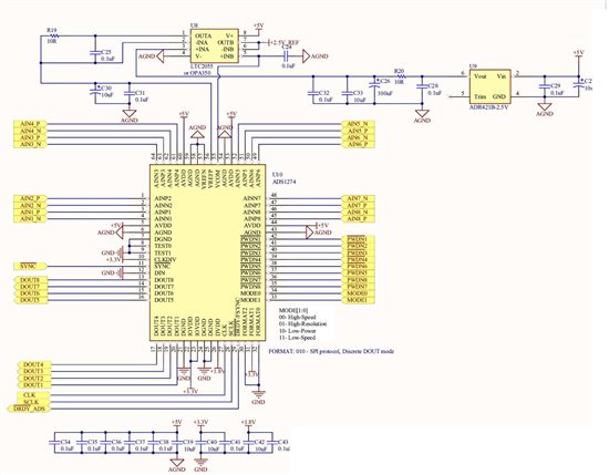

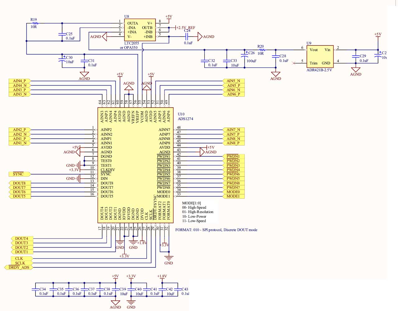

    Welcome to our forum!  Can you possible post a schematic snippet of your analog front end and give us a little more detail about how you are using the ADS1274?  If you can provide details on the operating mode, TDM vs Discrete output, speed/oversampling details; that would be helpful.  When you say the part 'fails', is this just an erroneous conversion result or is the ADS1274 physically damaged (i.e. needs to be removed/replaced)?
  • Hi, Tom:-
    Mode:    Mode 01, high resolution
    Output:  Frame sync
    We have a mix of ADS1274 and some ADS1278 in the same circuit. These are the most recent occurrences:
    Failure occurrence 1: No data for any channels.
    Failure occurrence 2: Serial data for one channel (it may have been ADC 2, but that is not certain) was unchanging regardless of input. Data for other channels appeared to be correct.
    Failure occurrence 3: Serial data for ADC2 corresponds to full-scale positive value, regardless of any input voltages on the associated pins.  The data for other channels is still present, and appears correctly correspond with the actual values.
    I've attached schematics. Not shown are schottky diodes from each analog input to ground to clip negative signals.
