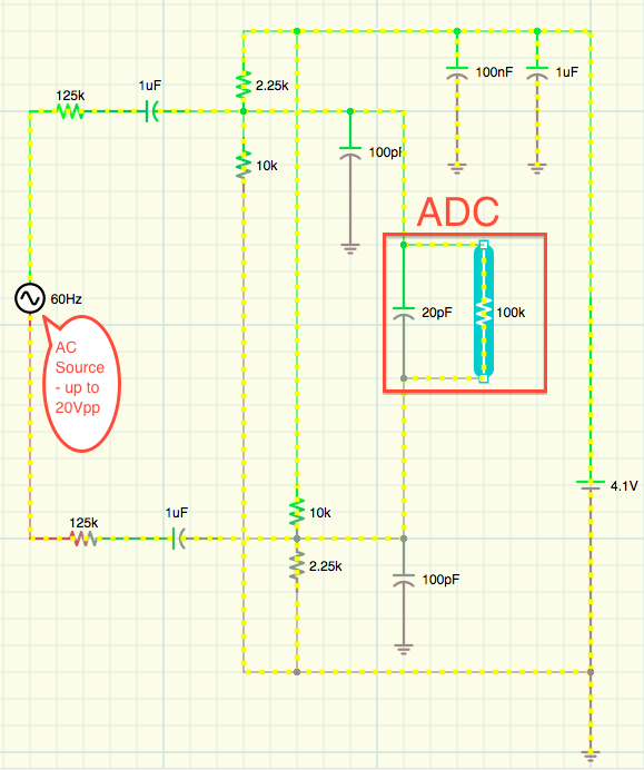

  • Hi Tom,

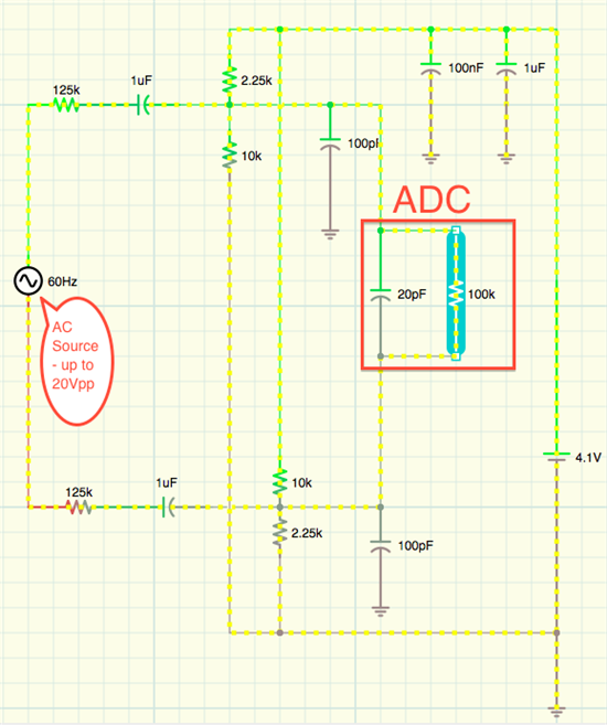

    Thanks again for the help.  I have since found the TI guide to buffering, which can be found here: http://www.ti.com/lit/an/sloa098/sloa098.pdf. I am following in the footsteps of example 3.6, i.e. figure 7. However, I do not think I need a buffer, I am merely sampling a 60 Hz signal.  So this is the circuit I propose instead for the ADC122S625. The common mode signal is generated via a 4.096V series reference, the drop-down resistors hence bias the signal to be centered around 2.5V.
    My question though is how to best model the ADC during operation? There is no mention of input impedance, just that the tracking cap is around 20pF. Is a 100K resistor assumption about right? Also, does this look like a proper differential input for the ADC122S625? Again, many thanks for your past help!
    Constantin
  • Hi Constantin,
    Sorry for the delay, but I am back :)
    What you are showing will impose a large DC potential (about 2.5V) across the ADC inputs. That, in my mind, is a waste of dynamic range as far as your signal is concerned. You may want to bias both inputs at 2.05V.
    Also, you signal will suffer a lot of attenuation on the way to the ADC input....
    I am sure you can work out the details.

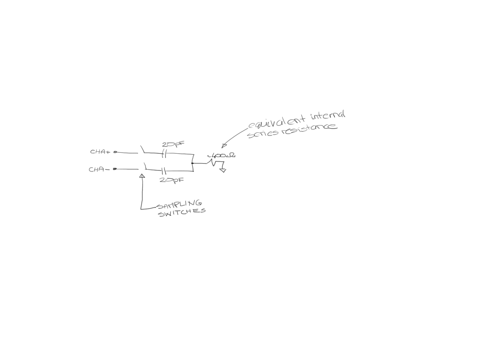

    I am attaching a simple equivalent circuit of the ADC - at least as far as your input source is concerned.
    tom
