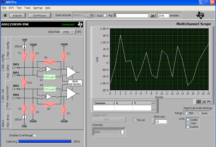

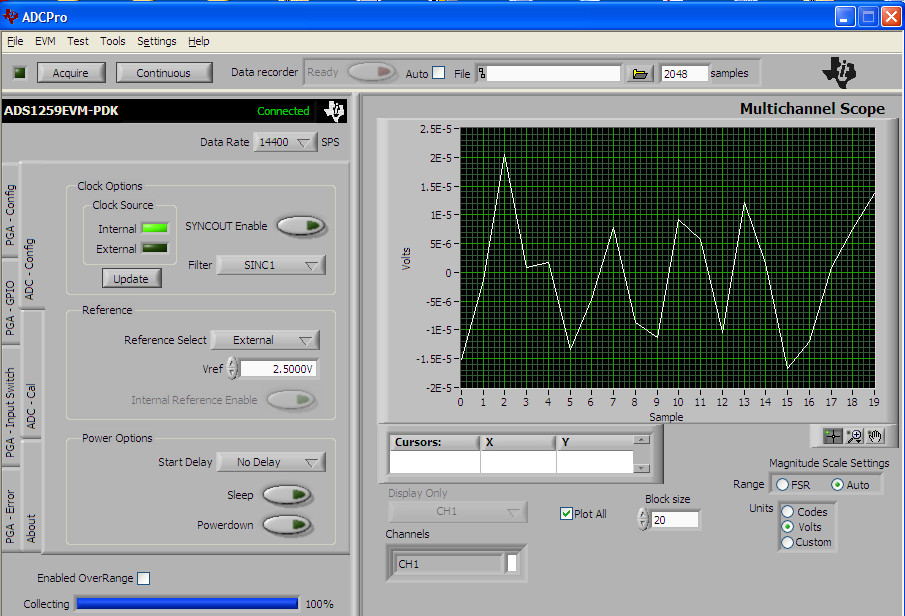

    The ADS1259 is set up at 14400SPS (with either SYNC1 or SYNC2 filter).  The PGA is set up with Gain 1V/V.  Please see the settings on the PGA Input Switch and ADC Configuration tabs below:

    The PGA280 register settings above appear to be correct; the PGA280 is set at a Gain of 1 with SWA1 and SWA2 closed  (connected to J8.3 and J8.4 header inputs).
    The ADS1259 is set up to be used with the external Reference, SINC1 Filter, external CLK, Pulse control mode at 14400 SPS.
