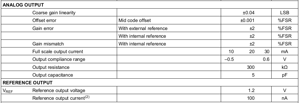

    But I still have some question about the DC specification of DAC output in datasheet, see the below pic.
    1. Why you don't add the output resistance (300 kohm) and capacitance (5pF) in your model?
    2. In your model the AC source is a 1A amplitude 100MHz sine wave. In real operation, what is the max. and min. range of output current?
    Can I control the value of output current?
    Thanks and Best Regards,
    David
  • David,
    1. Yes, you can add these two values as well. These are designer's conservative estimate and can be added before the package parasitic.
    2. The output current is not 1A. The actual DAC output is modeled with voltage controlled current sources. 1V of voltage supply means 10mA of AC current. There is also a constant 10mA DC current sourcing from the DAC. Both the AC and DC components forms the 20mAFS current. The amplitude of the AC current can be controlled by the voltage source.
