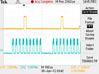

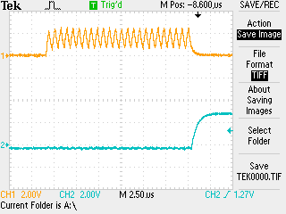

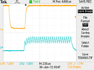

I added below signals and request your help to solve this issue. My signals look synchronizied with each other but the signals are not clean enough, I set triggering and it seems the pulse width of DRDY and CS signals are also changing. I am using ADS1298 development board with EVM 5515.
My SCLK signal seems not clean, I read meaningless data on DOUT. I use internal clock of ADS1298 by setting CLK_SEL, therefore ADS clock is 2.048 MHz. Conversion rate is 2 KSPS. SCLK is set to 500 kHz at first to ensure two byte opcodes (WREG and RREG) will be executed properly (wait 8 clock cycles between bytes). For the SPI data operation SCLK is 4 MHZ. For 2KSPS, minimum SCLK should be 2K * 9 * 24 = 432 kHz, well below 4 MHz (I also tried lower SCLKs close to 500 kHz).

SCLK with CS signal #1:
SCLK with CS signal #2:

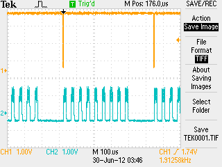

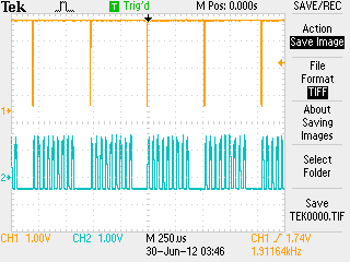

SCLK with DRDY signal #1:
SCLK with DRDY signal #2:
SCLK with DRDY signal #3:

    Not sure what to tell you about your START signal to the ADS1298, perhaps you can post your code for review.  The SCLK looks almost like you are driving into a large capacitive load - if you can post some sort of schematic showing the connections between the EVM's that might help.  The changing DRDY signal may be caused by latency in your ISR.

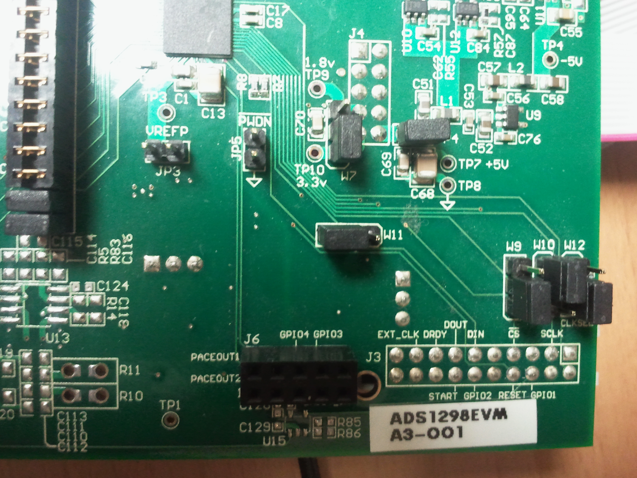

    I have just mounted ADS1298 daughter board onto EVM 5515, below is the pin configuration and jumper picture.

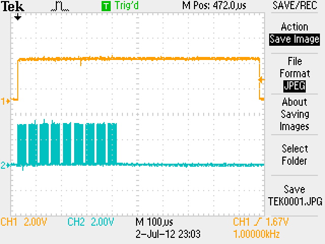

  • Hi Ekrem,
    The DRDY output from the ADS1298 goes to INT1 on the 5515EVM.  I suspect there is an Interrupt Service Routine (ISR) in your code somewhere that starts the transfer of data from the ADS1298 to the DSP by starting up the SCLK.  When conversion results are available, the DRDY signal goes low which should trigger an interrupt and start the SCLK.  Once the ADS1298 sees the SCLK, the DRDY signal is returned high.  The time it takes (i.e. the latency) for the DSP to respond to the DRDY input can vary slightly depending on what the processor is doing when the interrupt request comes in.  The other thing here is your SCLK - you need to figure out what is causing the erratic behavior - if the ADS1298 does not see a clean clock, you can get errors in the SPI transmission.
  • Hi Tom,

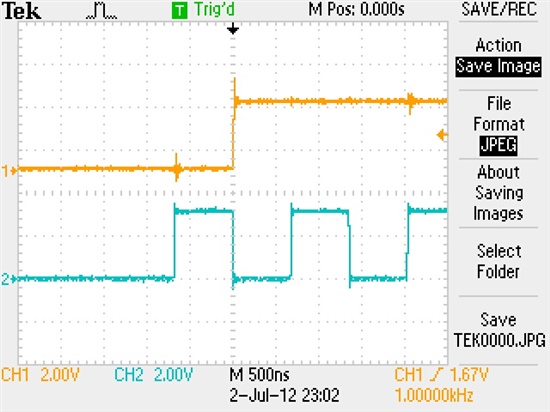

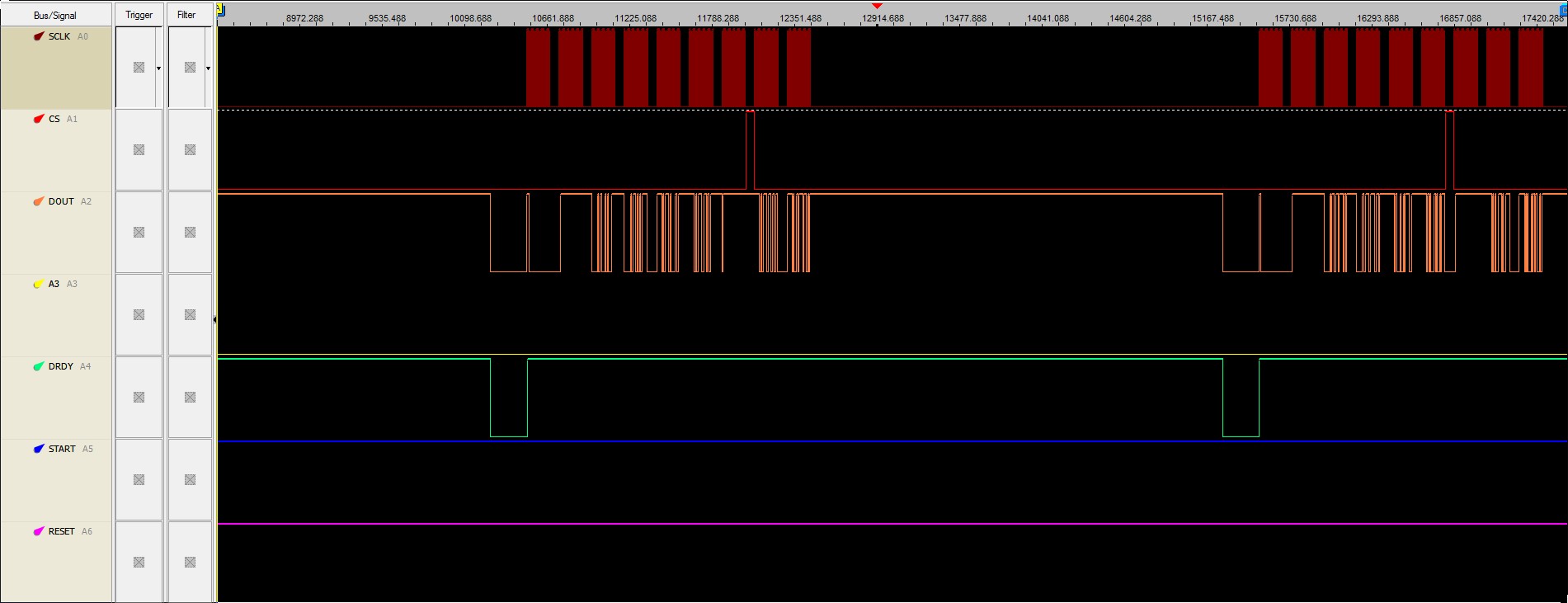

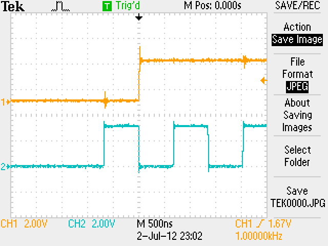

    Sorry for the late reply I was trying to try your recommendations. You are right there was a problem about ISR timings, after putting some timer interrupts the problem is solved. I also realized that SCLK problem was due to one of my connectors, I also change it and signals are good except CS signal. DRDY vs. SCLK signals are below:
    As expected DRDY goes high at the first falling edge of SCLK. I couldn't be able to put a CS signal since the signal never settles although I try several trigger options. It seems always changing and pulse width of it is always changing. I read a recommendation about SPI communication that when SPI communication corrupts we can correct it by just pulling CS high and low again. But how can we toggle CS signal when CS of ADS1298 is connected to CS0 of C5515?

  • Hi Tom,
    Here are my Signals on logic analyzer, I do not understand behavior of CS. I tried your recommendation and take CS to ground but after that DOUT signal disappeared and show always 0. START and RESET signals are also proper. Do you mean as Frame Sync the CS signal of C5515 or another signal?
