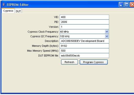

  • Hi Bootan
    The following procedure should re-program the proper information into the EEPROM on the board, provided an un-damaged, blank EEPROM is properly installed:
    Close WaveVision 4.
    Open C:\Program Files\National Semiconductor\WaveVision\wvprefs.txt
    Add “EEPROM=true” at the bottom of the file
    Save and close wvprefs.txt
    Turn on the board by moving the Rocker Switch on the rear panel to the ON position.
    Run the Wavevision 4 software on the PC.
    Connect the USB Cable from the PC to the ADC08D500DEV board.
    Go to the Tools pull-down menu and select EEPROM Editor.
    Fill in the table as the example here and then click the Program Cypress button. Once this is done, the Wavevision 4 software should recognize the board. If not, the EEPROM is damaged or some other problem exists.
    Jim B
  • Hi,Jim B
           Thank you very much for your reply. I programmed the EEPROM with your method, and now the wavevision software can recognize the board.
