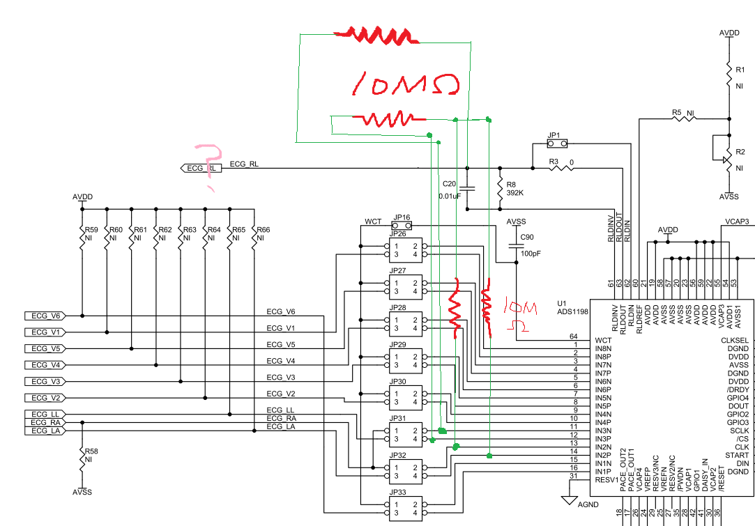

Hi all,

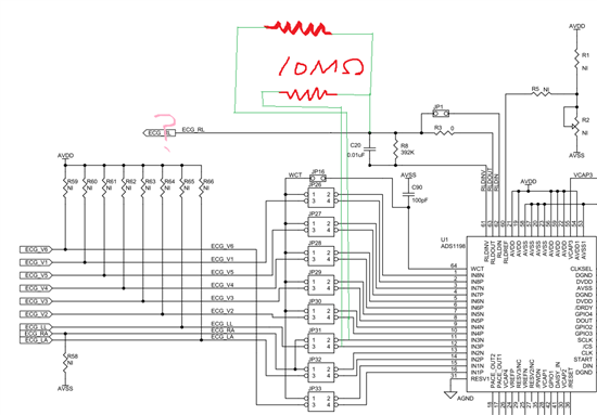

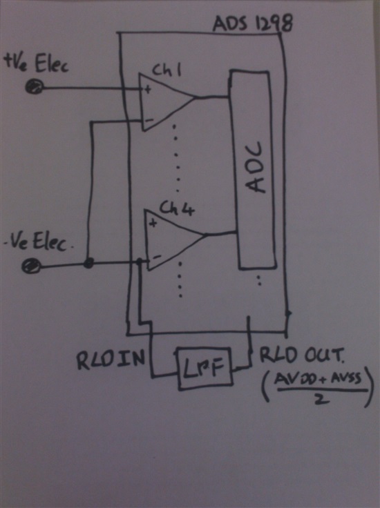

I am currently trying to use an ADS1298 device for a single lead ECG. I have some doubts about how I should configure this device. I tried to configure the device so that Channel 1 is used for the positive electrode, and then I used channel 2 for the negative electrode. I shorted out Channel 1 N and Channel 2 N together, and also connected Channel 2N to RLD.

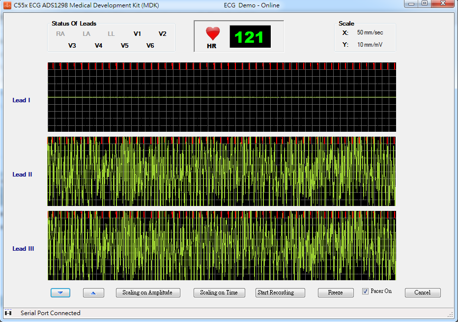

This means that channel 1 P is connected to an electrode and Channel 1 N is at RLD (where RLD is supposed to be (AVDD + AVSS)/2). However, when I output the readings, the output oscillates between positive and negative values, even if the input does not change significantly. My suspicion is that the inputs are drifting, thus resulting in an unpredictable output.
Anybody has any suggestions? Is there any way how I can configure the ADS1298 to use only a single channel for a single lead ECG?
