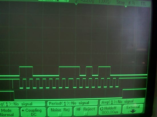

  • Here's a osciloscope graph of the data I send through the USB to SPI application that I built. The reference is set to external and it 3.3 (3.256 measured with the Voltmeter). The code sent is C3AC and the output of the DAC is 1.034 V, but the calculated voltage with the formula is 1.4945 V.
    Where am I doing things wrong? This is becomming a litte bit frustrating. Hope it's not transferable.
    Thank you very much for your support.
    Bottom trace is the nCS, middle one is the CLK and the top one is Data.

  • Hi Robert,
    Thanks for the screen shot!  Take a look at note (1) on the bottom of page 3 of the TLV5637 data sheet and let us know what your VDD rail voltage is.
  • The REF and VDD pin are connected to the same line which is 3.245 (3.3) V.
    This is the problem right?
  • Quite possibly - can you add a resistor divider to the VREF pin or perhaps source it differently by lifting the pin and see if that resolves your problem?
