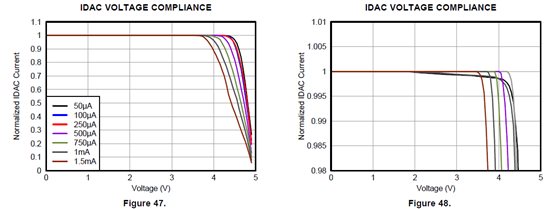

I am seeking the minimum Voltage Compliance spec for the DACs.  The data sheet shows typical (AVdd-0.7V) and a typical curve.
The design intent is to use muxes to switch the DAC current output to one of 16 channels; there may be as much as 100 ohms switch resistance in the muxes.  Because of this, there will be some voltage drop across the muxes, and there is a concern over when the current sources will begin to drop out, which is why knowing the worst-case minimum voltage compliance will be valuable.
In this design, AVdd is 5V.
Thank you in advance.
  • Hello Peter,

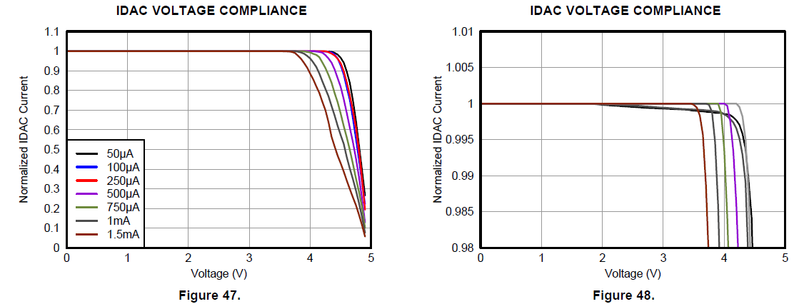

    Figure 47 and Figure 48 of the datasheet show a little more detail; the worst case compliance occurs with the 1.5mA setting.  This parameter is not guaranteed in the datasheet; so we can only provide an estimate.  At 1.5mA, ; with 5V analog voltage supply; the compliance is about AVDD-1.5V.  The plots below should be helpful.
    Luis
