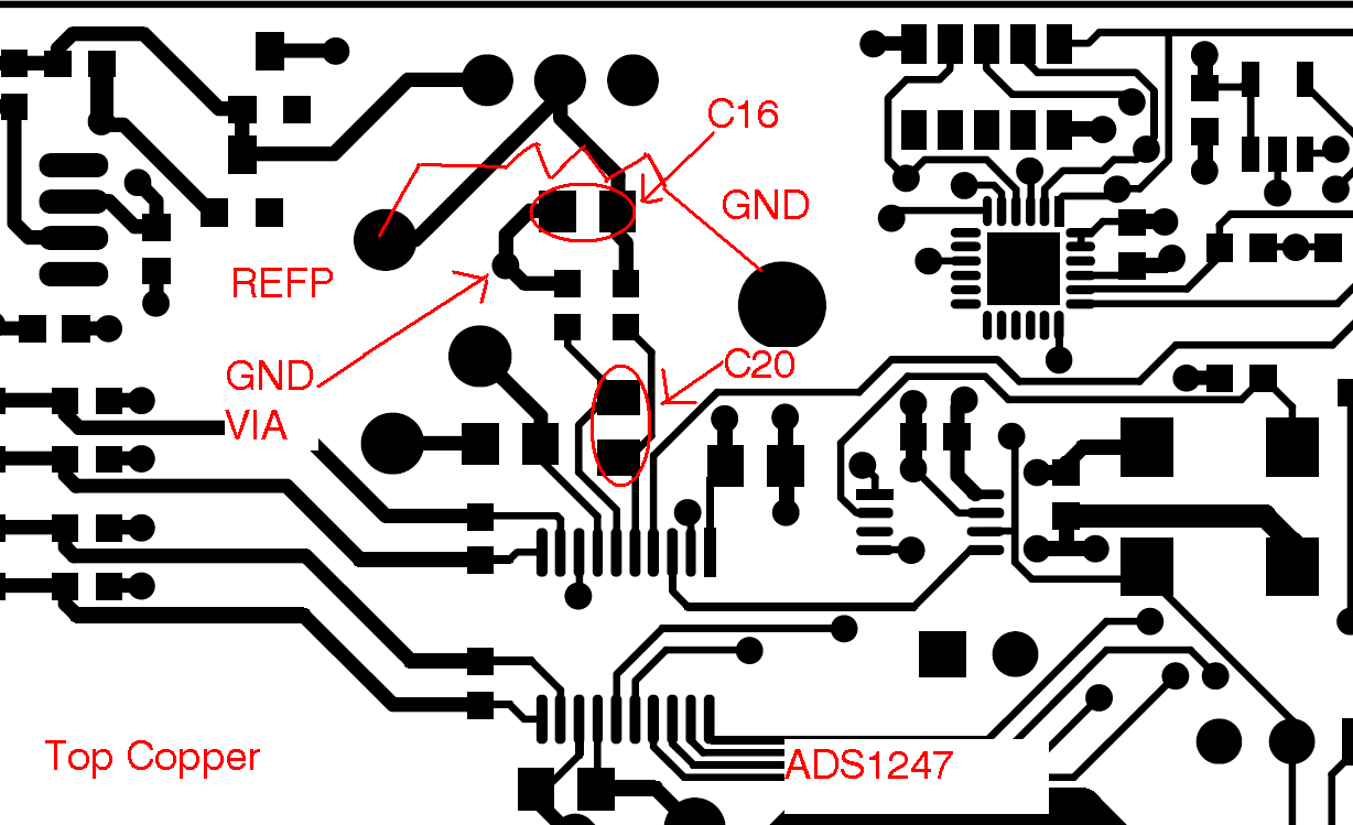

    There are a couple of things that are not clear.  Do you have your RTDs connected to the EVM?  Are you using 2 wire RTDs?  Can you send us a schematic of how you are connecting things up, as I can't visualize how you are doing this?  Can you send us some data?  This can either be raw data or pictures from ADCPro if that is what you are using for analysis.
    Noise is a problem with any system.  In particular, the noise performance tables you mentioned in the datasheet are best case scenarios with shorted inputs.  In practice it is really hard to match this in a system.  From your discussion it appears you have a good understanding of the noise problem.    Layout is a huge concern in overall performance.  Also, I would gain to the maximum possible gain staying within the common mode input range.  The actual noise becomes less dominant with gain.  This seems counter intuitive, but the signal to noise ratio does increase.
    If you are using the EVM, there are a couple of things to consider.  The first is the Rbias resistor should be placed close to the reference inputs.  The EVM doesn't really allow you to do that easily.  As you mentioned, noise should cancel in a ratiometric system.  However, any filtering will affect the phase difference between any filtered input and filtered reference.  The EVM has a 10uF cap near the reference inputs, and analog inputs also have filtering.  The analog filtering also effect the current path.  Another problem that can add noise with the EVM is the protection diodes (D1 and D3) at the external reference inputs.
    Another thing to consider is aliasing, and any high frequency signals (EMI/RFI) that can noise up your readings.  To eliminate this issue you need a low pass filter at the input.  If you are using a two wire RTD, any filtering done within the current path will affect the result.  With a three wire RTD you can have two current paths and cancel the series voltage drops.  If you are making a single measurement across all four RTDs at once, which is what I think you are doing, I would remove all components relative to AIN0 (R4, C7 and C24) and actually make the measurement across AIN2 and AIN3.

  • Rich,
    I would remove all components relative to the AIN0 input (you will have to replace R4 with 0 ohms, or preferably a short across the terminals), then use AIN2 and AIN3 for your sense connections.  You will see the largest benefit from the differential cap, which you do not currently have in your setup.  So I would not remove C8.
    I would remove the diodes at the reference input as you are generating the reference from internal sources, you don't have to worry about overvoltage protection.
    Before removing C20, I would look to see if there was any reduction in noise with respect to the input filtering.  I would also compare the internal reference to the external reference.  If you do not see any improvement, or if the internal reference provides better results, then I would try to improve the reference circuit by any means possible.  If you are using a leaded Rbias resistor you could attach across the test points REFP and GND.  If using a SMD resistor, you could try soldering it on top of the C20 cap (or removing C20 and using the existing pads.) This assumes the SMD resistor will fit in that space.  Notice that C16 is also in parallel, so you may want to remove that device and/or use it as pads for Rbias.  If your resistor is SMD and larger than the existing pads, you may be able to fit in one of the two cap spaces by angling the resistor slightly and scraping off a little bit of the soldermask from the copper trace then soldering the resistor in place.  This extra effort should help by lowering any inductance associated with the reference path.
