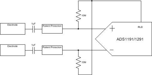

  2. My design will be one lead ecg ; only two electrodes; so how can i use pseudo RLD with ADS1292R ?

    2. My design will be one lead ecg ; only two electrodes; so how can i use pseudo RLD with ADS1292R ? One way is to AC couple the inputs and then use either the RLD or midpoint between the two power supplies to set the bias point at the the input pins using weak pull up resisters. As shown below

    I will use l bipolar power supplies ; so i will tie them to 0 volt (Avss  middle point) that what i understand from your post , Am I right?
    Do I need in this case a low pass filter two after the AC couple ?

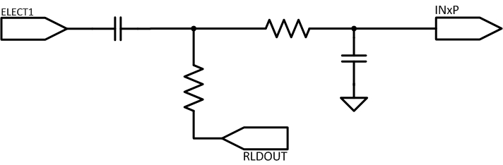

     Ads1292R has 3 pins(RLDINV, RLDOUT and RLDIN) for RLD. Where should i connect midpoint of resistors you suggested above? And What Should I do with other Pins of RLD
    Jaydeep Panchal
  • Hi Jaydeep,
    The midpoint of the resistor divider would connect to the input of the ADS1292. This would set the DC voltage at the input to midsupply with a pull-up to AVDD and a pull-down to AVSS. In this case, you won't need the RLD amplifier and it can be powered-down. RLDINV and RLDIN can be left floating.
    Alternatively, you could use the RLD output (RLDOUT) and use a single pull-up resistor between RLDOUT and the input node, as shown below. See the device datasheet for use of the RLDIN and RLDINV pins.

  • Hi Jaydeep,
    You still need to close the loop around the RLD amplifier. This is done by connecting RLDOUT to RLDINV. Using a parallel RC combination as shown in Figure 47, you can low-pass filter the output noise of this amplifier. Remember to select the internal RLDREF voltage (AVDD+AVSS)/2 by setting RESP2[1] = 1.
    After configuring the RLD amplifier, you can connect a high-impedance pull-up resistor to RLDOUT as shown in your schematic (R9 and R10). You will not need to install R1, R2, R3, or R4.
