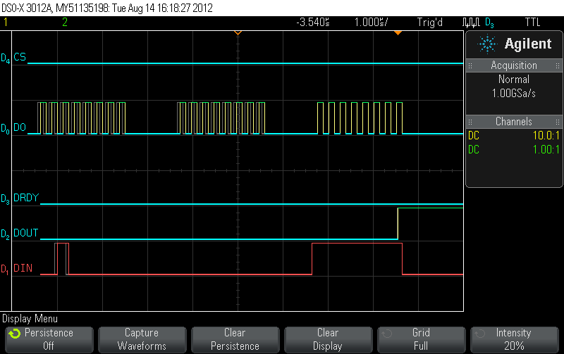

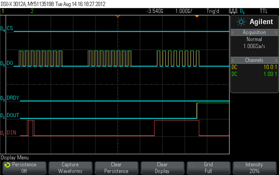

    Hello Luis,
    Thank you for your helpful feedback. I took your advice and tried to clear the output register by reading the current conversion, yet the response did not change. The screen shot shows no response from the device (please see bellow). Swiching to continous read, I dot get correct conversion though. Please let me know what you think.
    Hamid

  • Hi Hamid,
    It appears the SCLK frequency being used is around 4 MHz. The ADS1248 allows a maximum SCLK frequency in the order of 2.048MHz.  If you lower the SCLK frequency, does this solve the problem?

  • Hi Hamid,
    The SPI SCLK phase is probably the issue; the data needs to be shifted to DIN on the falling edge of SCLK.  The DIN data needs to be stable on the falling edge of SCLK and change on the rising edge of SCLK. The START and RESET pins must be held high and CS must be low during the complete communication.
    Whenever reading the registers, I typically simply send the SDATAC command and then issue the RREG command.  The SDATAC (x16h) command is 1 byte long and the RREG command is two bytes + the register data; so this should clear the output register.  The SDATAC takes effect on the next falling edge of DRDY.  You may also take a look at the post below.
