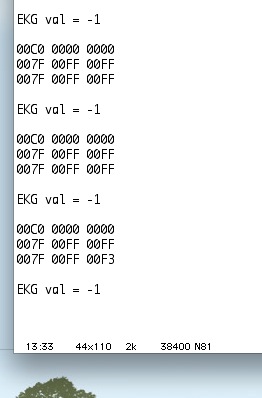

    For leads I'm just using regular 30 gauge wire. When the leads aren't shorted to each other I get the following output - usually 0x7FFFFF, but occasionally different values. Is this normal behavior from the ADS chip or should I check my SPI lines with a logic analyzer to see if data is being corrupted somehow.
    My data output is as follows - first line is Status, then Channel 1, then Channel 2. Ignore the EKG Val = whatever, i didn't finish that bit of code yet.

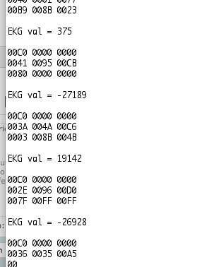

    When I short the two leads of a channel ( I shorted Channel 1)  to each other,  the values are all over the place.
    Shouldn't the value for a shorted channel be very close, if not equal to 0? Also, why would it be, as you said,  "in the neighborhood of 0xFFFFFx to 0x00000F"?

  • Hi Eric,
    Shorted inputs would be 0V differential, so the ideal code should be 0x000000 - there may be some counts of noise which is why I gave you the range of 32 codes as a ball park expectation.  Your numbers are a bit farther away from what I would expect to see though.   Unless you're saturated at positive or negative full scale, you will see some fluctuation in codes.  Verify your power supplies are correct and that you have the expected reference voltage at the VREFP pin (either 2.4 or 4.0V with respect to AVss) and let us know what you see on the VCAP pins.
    Go ahead and send scope shots (from an oscilloscope, not a logic analyzer) and we'll take another look.  Don't fixate too much on 'EKG chips' just yet, the ADS1292R is still a data converter and it works just like any other delta-sigma ADC.

    Now I wrote to the CONFIG2 register and enabled the internal reference. Now I see a 2.4V on the Vrefp line.
    The lines  of the first channel are shorted to each other on this session.
    Does the output seem correct to you?  ( Again, first line is status, second line is the first channel, last line is the 2nd channel)

  • Hi Eric,
    Thanks!  Your current conversion results look much closer to what I'd expect to see with shorted inputs to the ADS1292R.  Next step - try the 'input short' configuration and you should see the offset values internal to the part along with the test voltages..  From there, try your 10Hz sine wave again and let us know what you see.  If your are configured for a uni-polar input, you'll have to accommodate the CM voltage with a bit of offset from your signal generator (i.e. Vref/2).
    EDIT: Next step - try the 'input short' configuration and you should see the offset values internal to the part.  From there, try your 10Hz sine wave again and let us know what you see.  If your are configured for a uni-polar input, you'll have to accommodate the CM voltage with a bit of offset from your signal generator (i.e. Vref/2).
