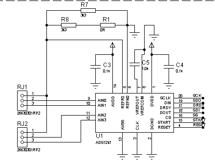

I build this circuit to work with two 3-wires PT100:
Well, now I wanna read AVDD (or DVDD) value, then 1st PT100 (RJ11_1) and then the 2nd PT100 (RJ11_2).

  • Hi, everybody. Sorry for this delay time, but I'm back with more questions and concerns! ;-)
    Let's start from the beggining. Nowadays, my schematic is this one below.
    1) Is this correct? Two 3-wire RTDs (PT100) will be connected at RJ1 and RJ2.
    The supply voltage is 3.0V. And my Rbias is 1.65kohms (3k3 // 3k3). My IDACs are configurated to generate 500uA each one (IMAG@IDA0 = 100).
    My PGA is 16 (PGA@SYS0 = 100), so my full scale is 1,65V/16 = 103,125mV. This allows me to measure high temperatures as 200ºC (± 175,8ohms), which generates me 87,9mV with IDAC=500uA ( 175,8ohms * 500uA = 87,9mV).

  • Hi Daniel,
    This looks ok, you just need to be careful with possible drift issues with the parallel resistors.  The Rbias for the reference should be a low drift high precision resistor.  The register settings look ok as does the equation.

  • Unfortunately, I'm still having problems.
    I just receive 0x7FFFFF as answer after a RDATA command.
    I was taking a look at the voltage in Rbias, and I saw just a half of what supposed to be. In other words, I measured 0.825V instead of 1.65V, what is weird once my IDACs are set to 500uA (as I wrote a few posts ago).
    It's probably messing with all my settings, isn't it?
     Any idea?
    Thanks in advice!
  • Hi Daniel,
    If the Rbias resistor is only dropping 1/2 the expected voltage then current is missing either by improper IDAC routing/configuration or improper wiring.  You can read back the register to see if the problem is an incorrect setting.  You should also be able to detect which current source is missing by either turning on/off current sources or by removing one of the RTD leads to see if the current through Rbias is no longer present.
