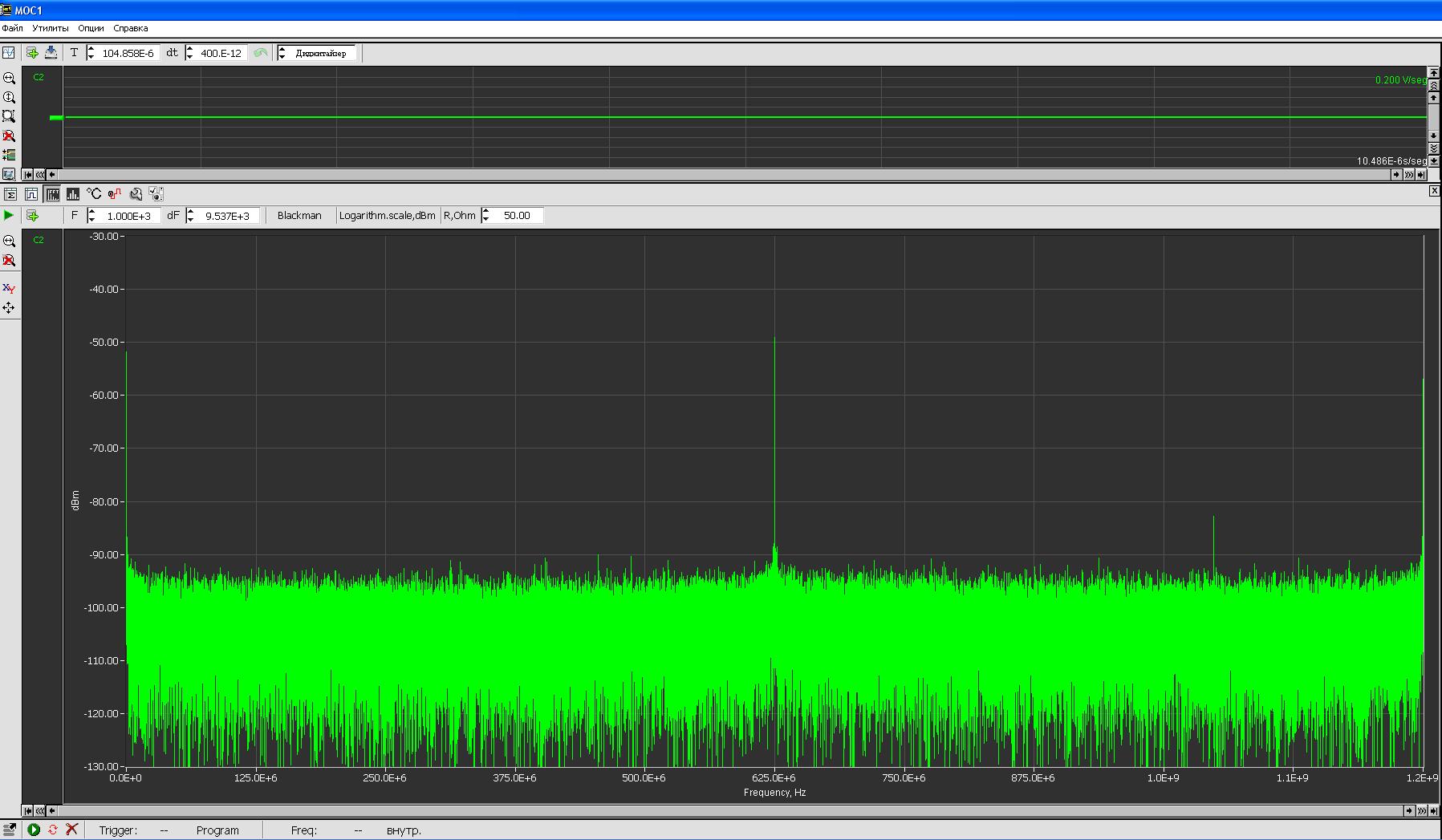

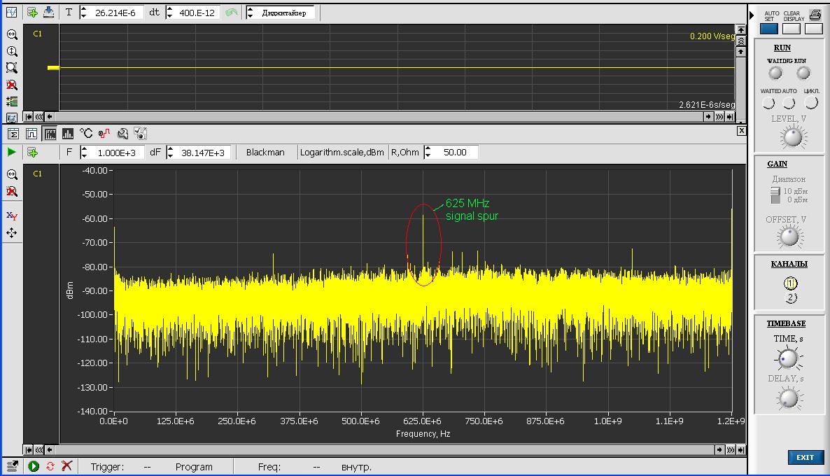

I have developed digitizer based on ADC12D1600. ADC works in DES mode with sampling frequency Fs = 2,5 GHz. ADCs input mode is DC-coupled with FSR 1000 mV. Data outputs are not demultiplexed (Not-Demux DES mode).
On a spectrogram, that I have gotten from my device I see parasitic signal spur on 625 MHz, which is 1/4 of my sampling frequency. When I change sampling frequency to Fs = 1,25 GHz appears 312.5 MHz signal spur. Spur level is about - 55 dBm. I think, it's not induced on ADC inputs (although I could be wrong). Full scale range and DES timing adjusting lowers aliasing frequency (Fs/2 - Fin), but doesn't affect on Fs/4 signal spur.
I found a datasheet in which is making comparison RF and not-RF versions of ADC12D1x00. As I see on this picture each of AD12D1x00 ADC channels (I and Q) consists of two subchannels (I1 & I2 and Q1 &Q2). Is that means that I and Q channels works in their own interleaved mode on Fs/2 frequency? That may be cause of Fs/4 spur appearing in DES mode...
Here is said, that ADC12D1x00RF has fewer interleaving spurs in DES mode on Fs/2 and Fs/4. So, should I use RF ADC instead of not-RF version to cancel problem with Fs/4 spur in DES mode? Or, may be I did something wrong during design process. Please help me to solve this problem.
Thank you.

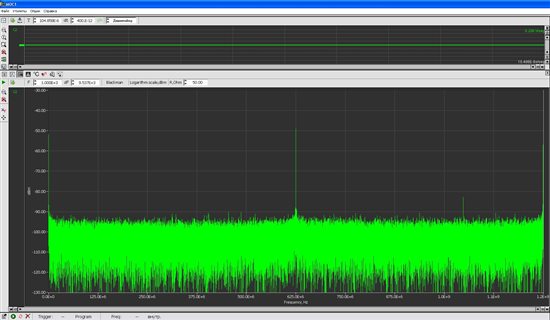

  • I removed input resistors and leave ADC I-channel inputs floating.
    Then, I made measurement in DES mode with Fs=2.5 GHz, and had got this:
    As you can see all induced noise and differential amplifiers own noise is canceled. But 625 MHz parasitic spur is still here.
    What may be a cause of this?
  • Hi Deus,
    Sorry you are trying to debug this issue.  Let me show you the source of the Fs/4 spur first and then consider what can be done about it.  -55dBFS sounds a little high compared to what I typically see, but it is possible, especially with the DCLK coupling in addition to the offset mismatch and the sub-converter clock.
    There are three sources which contribute to the Fs/4 spur in DES Mode for your application:
    • Offset mismatch between sub-converters in a 4x interleaved data converter.  The ADC12D1600 has actually 2x interleave per channel, so in DES Mode, this totals to 4x interleave.
    • Sub-converter clock.  Each channel is actually being sampled at Fs=625Msps, which also lands at Fs/4 for the DES Mode (Fs=2500Msps)
    • DCLK: Non-Demux DDR Data Clock (DCLK) is running at 625MHz, which lands at Fs/4 for DES Mode
    Regarding the 'Fewer Interleaving Spurs' image you pasted in, let me clarify a little.  The 'RF' parts have better distortion than the non-RF parts, but they still have this issue with the spur at Fs/4, since it is due to parasitic clock coupling.  For example, the ADC12D1600RF will still show a spur at Fs/4 in your system without any input.
    Regarding the ADC12D800/500RF having fewer interleaving image spurs, that is true, but it will only affect the spurs at Fs/2-Fin, Fs/2-H2, Fs/2-H3, ... Also, the faster product, the ADC12D800RF, will only run at maximum 1.6Gsps in the interleaved mode, and you need 2.5Gsps for your application, so that product is not a good fit.
    To minimize the Fs/4 spur:
    • Calibration should minimize the offset between the ADC sub-converter banks.  From the FFT, it looks like you calibrated, but please just verify that you did.
    • If you use a Demux DDR DCLK, then the Fs/4 spur contribution from the DCLK will move to Fs/8.  Depending on your application, I'm not sure if this is acceptable or not?
    • To minimize the contribution from the sub-converter clock, it's possible that reducing the level of the clock at the CLK+/- inputs may help, but I need to check this idea in the lab.
    There are a couple keys to solving this issue: to determine which contributor is the main culprit and see what may be done to reduce its level, and to understand what the minimum acceptable level for your application is.  Can you tell me any more details about your digitizer application performance requirements?
