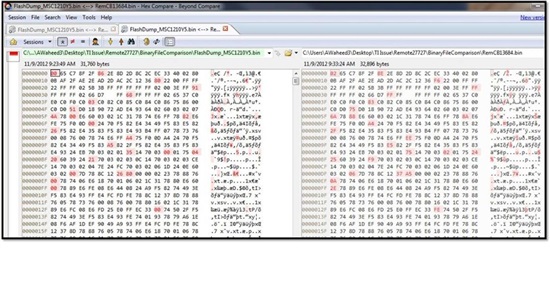

I am right now facing the problem of bits flip in MSC1210 Flash and need your kind help on it. The detail of the issue is,
"We are using MSC1210 microcontroller in our high temperature downhole product for Oil field services. Recently we received 4 cases of our product failure  and these failure turned out to be caused by the microcontroller MSC1210(microcontroller stopped working/Stuck). For investigation purpose, we compared the firmware (hex) file downloaded (at the time of programming this micorcontroller) and the firmware (hex) file read-back (after failure) from the same micorcontroller. By right these 2 files should be same, but to our surprise, we found out that there are differences in the Code Flash memory contents at 2 address locations, which corresponds to 2 bytes, as shown in the table below Also please find in the attachment, the screenshot of the comparison of correct hex file data (on the left side, highlighted red) and corrupted hex file data  (on the right side, highlighted red)
Address Location
Correct Data Byte
Corrupted Data Byte
Remarks
0x0000
0x02 ( binary = 0000 0010)
0x00 (binary = 0000 0000)
2nd data bit (from right) is flipped from 1 to 0
0x0080
0xB4 (binary = 1011 0100)
0x80 (binary = 1000 0000)
3rd, 5th and 6th bits (from right) is flipped from 1 to 0
Importantly, the flash memory is programmed as write – protected (with default HCR0.PML = 1). All of 4 product were failed at low temperature (not even exposed to high temperature).

    Hi Bob,
    Reference to previous reply, I have completed the failure investigation on another flash. This flash seems to have 26 bytes corrupted. Interestingly, all bits flip happened from 1 to 0, as shown below in the screen shot. This screen shot is from the hex file comparison between the programmed hex file (right) and the corrupted read-back hex file (left).
    As per your query, both flash failures have data corruption at the start up address locations (0x0000 - 0x013A) only, though not all the corrupted address locations are same in the 2 flash failure cases.
    Could you please share with us, which event is actually causing this error and how could it be avoided?
    Asad.
