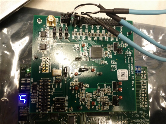

Can somebody comment on this particular setup?  I am getting some results, but I am not sure if they are optimal.
I have single-ended inputs connected to the +pins of CH1 and CH2.  I have jumpers on the -pins of CH1(33-34) and CH2(29-30) to the left side (J6).
I have jumpers on 3-4 and 5-6 of JP25 to connect BIAS_ELEC to all INMs and to short BIAS_ELEC to REF_ELEC which connects to SRB1.  I have closed SRB1 in the software.
I have jumpers on 1-2 of JP6, JP7, JP8, as the factory defaults suggest.
I have the bias electrode connected to pin 2 of JP25.  I do not have the reference electrode connected, though I did try it on pin 3 of JP8, though I'm not clear if it actually changed anything.
Is this a good way to set this up?  I am using a 64-channel headset with single-ended electrodes, but for the sake of simplicity, I am only actually using 2 channels plus reference and bias (ground).
Please comment on whether this makes sense, whether other settings need to be adjusted, or whether the pins / jumpers being used are wrong.
Thanks. I am including a picture of the setup.

    It looks like the 'black' leads in your picture are floating, can you tell us what they connect to in your cable?  Is that perhaps the cable shield?
  • The black leads are floating at both ends, they are disconnected.  They have no impact on the setup. Those are just the cables we happen to be using, when we move past the development board (we'd like to use the chip in a wireless setup) we won't be using them, so I've just treated them as single-ended cables.  The white end of the cable is connected to the development board and to a board that connects to our headset, the black end is left open at both ends.  Alternately, we could connect the black end and leave the white end open.
    Does the rest of it make sense, ignoring those?
  • I really just want to be clear on the Bias and Reference electrode connections, as the headset has dedicated Bias and Reference electrodes.
    My assumption is that I should put a jumper on JP25 pins 3-4 to connect BIAS_ELEC to INMs and 5-6 to connect BIAS_ELEC to REF_ELEC (as suggested for single-ended electrode configurations)
    Then I have connected the Bias electrode to pin 2 of JP25, so that it connects to the negative pins of J6.
    Then I have jumpers across the negative pins of the channels in J6 (i.e. 33-34, 29-30, etc)
    I'm not sure where to be connecting the reference electrode? Is it to one of the pins in JP6, JP7, or JP8?
