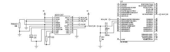

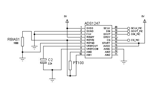

  • Hi Bob, Here is the schematic of the design i am using. Unfortunatlly i can´t attacht a scope of the comunication because as i told you when i connect the osciloscope, all the signals go to zero. Now I have the follow configuration of the registers:
    MUX0=0X01. VBIAS=0X00. MUX1=0X020. SYSO=0X71. IDAC0=0X06. IDAC1= 0X01. given that i can read the registers using the RREG instruction, i can assure you that they are correctly written. And the Microcontroller allways receives MSB=0X7F and the rest is 0xff and the voltage across the Rbias is 3V and across the RTD (between AIN0-AIN1 at 25°C) is aprox. 100mV. I want to meassure between 0 and 50°C. If i am using only one RTD connected in three wire configuration between ain0 and ain1, Should i use the IDAC2 source?
    Take notice that Avdd=Dvdd=5V, Is ok to do this?
    Best regards
  • Alfredo,
    You need to create a current path to ground.  You need to connect the RBIAS/REFN0 connection to ground.  I think what may be happening is when you turn on VBIAS a ground path through the input is created.
    Bob B

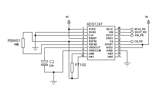

  • Hi Bob. Today i could check the connections of the device and i could see that the pin RBIAS /REFN0 is connected to gnd , and the registers are configurated as you told me before vbias=0x00 and mux1=0x20, so the project is working as same as allways. I could note that if i change the value of the RBIAS the convertion´s result is the same. I connected a led to the pin DRDY and i could see that the led is the most part of the time off, and later became to 1 just for a very short time. I supposed that pin works exactly the opposite, it will be down when the conversion was ready and the rest of the time would be to 1'. The led´s anode is connected to the pin and the catode is connected to gnd with a resistor. Do you know why is working in that way?. I have DVDD=AVDD=5V and in the p 57 of the datasheet, AVDD=5V and DVDD= 3.3V do you think the problems is in there?
    I attached the final schematic
    Thanks for your answers. Best regards
  • Hi Alfredo,
    One thing I should have mentioned earlier is the START pin must  be high when writing the registers.  This pin is like a power down pin.  It not only powers down the ADC, but you will also power down a portion of the digital.  I would suggest you leave the START pin high until you are fully satisfied with the operation.  After that you can use the power down modes.
    As far as DRDY operation, the pin will only go high when new results are  being updated if you do not read from the device.  When you read data from the device, the DRDY pin will go high until the next updated has been completed then DRDY will go low.
    Bob B

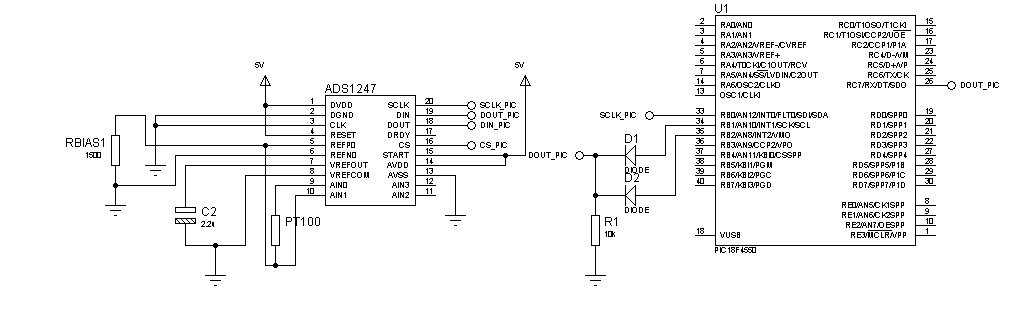

  • Hi Bob. As i showed you in the schematic I have the START pin connected to 1´all the time. I tried with two different ads1247 and i have the same response from the device. Do  you thing that my problem is in the firmware? In that case which would be my error (my source code is in the beggining of the post)? Did you considered my last question about the source (AVDD=DVDD=5V) ?
    Best Regards.
  • Alfredo,
    I'm sorry I didn't take a closer look at the schematic.  Yes, I see you have START pulled high.  You can use the same 5V power supply for both AVDD and DVDD.  This now takes us all the way back to the beginning in that we need to verify the communication.  The only way to do that is either with a logic analyzer or oscilloscope.  Using an oscilloscope should not short out the output, and is much better for verification as compared to using LEDs.
    Basically you need to verify that SCLK dwells low, and that the data is transitioning on the front edge (rising) of SCLK going to the part.  Just verifying by writing to a register and reading from it does not necessarily mean that the register value is actually what you think it is.  If you are writing the register incorrectly, you are also reading from it in correctly.
    I haven't used a PIC in quite some time, so it would be difficult for me to verify your code.  It appears to be correct,  but if the SPI is setup incorrectly, you will not get the proper results.
    Bob B

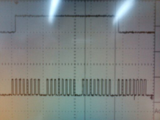

  • Hi bob, next i´ll show you a sequence of images that i obtened in the oscilloscope. The first group are the data sends, the second one are the value of the registers read it from the divece and the last one is the result of the conversion:
    First group (send it) probe connected in din of ads1247 and clock:
    The sequence of this group is: sdatac(0x16), write registers (0x40), write 4 registers (0x03), mux0=0x01(0x01),vbias=0x00(0x00),mux1=0x20(0x20),syso=0x71(0x71),write registers from address 0x0A (0x4A). Then i stoped to photograph but i write the registers idac0=0x06 and idac1=0x01. The last picture is only to show the time in which is working the device.
    1108.send it.rar
    Second group (read it) probe connected in dout of ads1247 and clock:
    The sequence of the data that the PIC receibe from the ads1247 is: mux0=(0x01),vbias=(0x00),mux1=(0x20),syso=(0x71) then there are 0x00, 0x00 what corresponds to the function (0x2A) and (0x01) and finally the next data are idac0= 0x86 and idac1=0x01.
    0488.read it.rar
    Last group, probe connected in dout of ads1247 and clock:
    Is only one photo in wich i receive only 0x7f, 0xff, 0xff
    I hope you can help me. Please forgive my bad english. Thanks for yours answers. Best regards
  • Alfredo,
    It appears that the basic communication is ok.  How are you reading your data?  Did you turn RDATAC mode on?  Or are you using RDATA command?  Why are there 4 bytes of clocks on the posted picture of your results shown above?
    Bob B

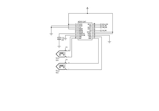

  • Hi Bob. thanks for your answer. I have the next configuration of the registers:
    mux0=(0x08)
    Vbias=0x01
    Mux1= 0x30
    SYSO=0x40
    IDAC0= 0x80
    IDAC1= 0xff
    And this is my schematic diagram:
    Is this ok? Should i change some value? Should i connect something between REFP0 and REFN0? remember that i want make the cold juntion compensation with a monolitic sensor. Thanks for your answer again Bob.
    Best regards
  • Alfredo,
    You can use those values depending on how your TC is actually configured and connected.  To follow the schematic you may want to change MUX0 to 0x01 and VBIAS to 0x02.
    Bob B

  • Alfredo,
    Even though you can leave the REF pins floating, it is a good idea to terminate any unused inputs (like connecting them to ground.)
    If you have issues with respect to reading and writing, you need to verify that the data being sent and received is what you are seeing as a result in your code.  The best way to do this is with an oscilloscope to verify that the data for both read and write conforms to the correct timing.
    Bob B

    Is it possible for you to send me oscilloscope pictures of the SPI communication?  I don't think the communication is working as well as you think it is otherwise you should read back what you have written to the registers.

  • Hi Bob. Thanks for your answer. I must tell you that i could fix my problem, it was just a programation mistake. Now i am having problems with the equation. I have the TC in 60°C and i can read the next convertion: MSB=1, 111, 120=LSB (when the TC is reading the environment temperature i have the next reading MSB=255, 117, 150=LSB e. g. I don´t understand why is this happening if for temperatures above 0°C the MSB should be between 0-127) then i use the next equation:
