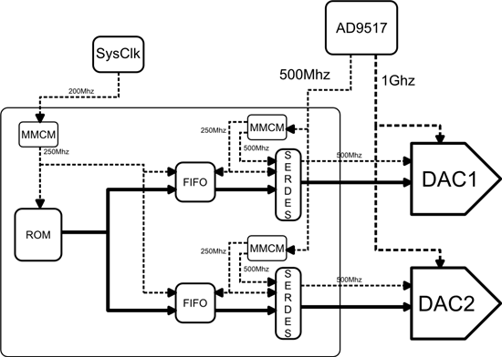

I finally could configure both DAC properly. So, I designed this data flow, in order to evaluate the system. My original system will work with data frames instead of stored frames, so I need to provide a continuous data flow.
As you can see, I read a signal stored in a ROM with FPGA clock. Then I send the data to another clock domains through some asynchronous FIFO.

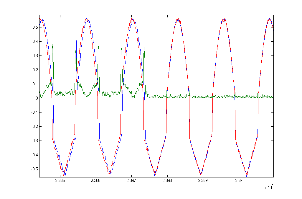

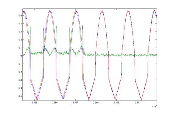

By using an oscilloscope, I observed that this signal is showed with the proper tension level, but every now and again something happend in time domain.

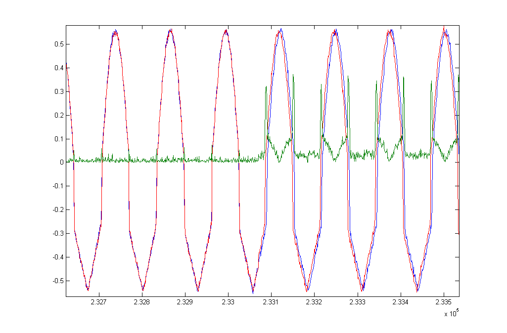

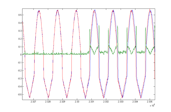

In this another captured picture, both DAC are synchronized, but in some moment, one of the DACs some samples are losing, and signals are desynchronized.After some small random period, some samples are losing in the other DAC, as you can see at this other picture.

As far as I understand, all of these created clocks couldn't not be the same. I mean, maybe one has 249.99Mhz, and the other one has 250.01 Mhz, and this can produce that FIFO pointers can cross.

    Yes, it seems like the clocks are not synchronized among the different time domains. How are these clocks being generated? Can you draw a diagram of where all of the clocks are coming from and where they're going?

  • Hi Matt,
    As you can see at this data flow, I generate DAC clocks with AD9517 device, from Analog devices. As far as the ROM clock is concerned, I use the clock system.
    I use different MMCM in order to provide the properly clocks.
    Jose
  • Hi Jose,
    Thank you for the detailed diagram. Since SysClk and the AD9517 are not synchronized, it is not unexpected to see the shift in data. The easiest way to fix this is to synchronize the SysClk and clock chip. I'm not familiar with the AD9517, but the LMK04800 from TI could be locked to the SysClk using the internal PLL. The other option, and probably easier one, is to use the clock chip to generate the system clock. Can you bring a clock from the AD9517 onto the board as the SysClk?
